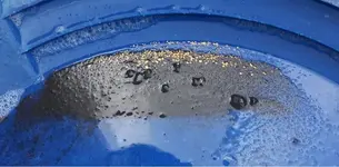

Drove up to Dewey today to help Woody get his Gold Well set up and give him some tips. A neighbor of Woody's has been working Lynx creek and gave him 5 five gal buckets of solid black sand. This was tailings from his sluice, la trap and panning. The black sand was beat to death. Got the unit set up and told Woody lets dump that beat black sand into the Gold Well. Ran 2 gal and panned the results. A ton of fine flour gold was recovered. Pieces so small I could not believe it. Woody has been doing this since 69. Said he never used a unit that could catch gold that fine. The attached photos are from my I Phone. Even my phone could catch all that gold in a photo. Woody is a very happy man! I'm so happy for him. Thanks again Bernie!

Gold well gets it all!

That's pretty good for a 5 gal bucket Sarge! :laughing7:
Give us the straight scoop, how much material and where were you working? :dontknow:
Why Clay the Lost Dutchman of course. 3 three gallon buckets.

Trick is to adjust your water flow until the material starts churning in the holes. No more. Look close at the first photo. Everything from nuggets to fairy dust. This batch was not screened. Had rocks up to 3" but most material was quartz gravel 1/2" size and down. It depends on material. I like 1/4" screen but it depends on where it comes from. Dry washer stuff cleans up fast.
