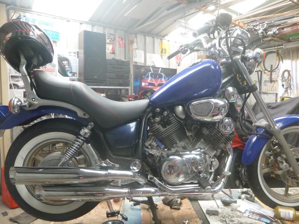

I was thinking taht to get started i need the quad bike first. So my first step was to advertise my restored Yamaha Virago, and turn the ~$5K I have 'invested" (that's a lousy word for anything associated with motorbikes or cars - since they are depreciating assets) into a good deposit on a used quad bike - that I can go thru every nut and bolt and make it reliable and like new again as a starting point.
Unfortunately in this economy no one seems to want it yet, being ~24 years old - even tho I spent about that just on new parts for it from USA, as a restoration project (never mind the hundreds of hours of free labor that went into it).
Next year it becomes a vintage at 25 years old - maybe then interest will pick up?.
Seems no point out laying about that much again into a used quad while I have that much tied up in a 2 wheeled resto motorbike bike that I am not riding!.
