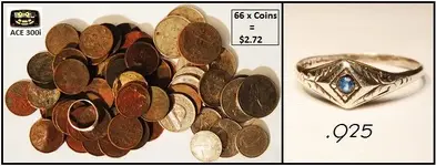

Shown below are my last couple of hunts with the Garrett ACE 300i. Those ACE's sure are coin/jewelry magnets.

Nice finds! Thanks for sharing...
