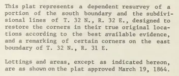

Here is the section shown in the most recent survey from 1978.
The scope of the survey and a pointer to the 1864 survey as authority for the subdivisions portion of the survey.
The 1864 survey
All those seem to indicate that the area was never designated as a lot and was never surveyed for quarter quarters.
That would make the Land Matters PLSS wrong.
The problem is if that strip isn't broken down as quarter quarters on any map and it isn't designated a Government Lot what the heck is going on?
The place to find the details as to why a survey is made one way or another is to read the Survey Field Notes. Those will tell you why that area is so wacky.
Here link to the survey field notes for your area of interest. These field notes can be very revealing. They don't just have notes about pins and distances but they have a running description of the land and how it was being used. These handwritten notebooks can be difficult to navigate and a little confusing but I would suggest looking them over very carefully. I did a quick look and there are some pretty good notes on your area. Don't get so buried in reading about who lived where and where there were minerals being mined that you forget to look at the instructions for the survey. *wink* wink hint hint.
You think that the "Lot" designation was removed at some point but there is another possibility I'm guessing you hadn't considered - the land is still unsurveyed.
Looking at the documentation for the PLSS doesn't show any protracted survey in that Township. The entire Township has been surveyed including government lots and aliquots. That's why they assumed the strip was a government Lot. I think they may be wrong because I think I saw something in those survey field notes about instructions not to survey particular 80 acre strips. *wink ahh!*
On unsurveyed unprotracted lands you can claim by a logical regular unofficial protraction or metes and bounds. I usually locate all claims by both no matter which type of claim but set the lead page for the aliquot description for placers.
So who's right? I think I would go a little further and see why the cadastral survey now considers those strips to be lots and why the BLM doesn't. Armed with the information from your search that should be an interesting conversation. The answer you get there would answer your question ...maybe. I'll let you take it from here. :laughing7:

I couldn't find anything that said.
"in order to claim a portion of a gov. lot the locator must make a description based on metes and bounds.
Only the aliquot part or complete lot info I shared.
when we did it, it was ok cause we wanted all of it any way.
I've always been confused about it couldn't get a strait answer or example to compare.
The mistake I made is that I thought a lot was a "legal subdivision" so it wasn't about it conforming.
So , if you want part of a lot that is not "conforming" so your naming what you claim by metes and bounds to locate it within those lot boundaries?
Clay your post above is a gold mine of good info.
Holy cow you can talk the talk on this stuff!
I'm impressed.
I only fixed the placer claims that were in Government Lots 3-6 by using metes and bounds.
The strip of land to the right of those Lots I was told by the BLM Reno are now aliquot so I followed their guidance.
But you brought up some very interesting points about exactly what was the intention not only of the original surveyor but the later revisions to the MTP.
Well done!
