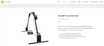

Hello everyone,
I would like to buy a DIPOLO GRP from OERAD, is it good GPR? has anyone among you used this GPR please give me your opinion

It was delayed but came yesterday. Setup isn't too bad and walked it around the backyard this afternoon. It worked and I was getting readings. It isn't too heavy but you still have to carry it around.
Learning to interpret the readouts and gain a sense of what I am looking at is going to take some time. There are a lot of variables including three different antenna and many settings. Different soil types also reflect with different intensities. I am going to have to get out and play with it in areas where I can dig and bury a few things. Overall I think it will be great, but I will have to commit some time to getting the hang of it. Unfortunately we will be getting rain all weekend so it will have to wait.
I am in North Georgia about an hour north of Atlanta.
Took it out into the woods today for a test run. It operated for about 10 minutes and then I started getting a message that it could not find the radar. I also got an error message about the media source not being found on the tablet. I started and restarted the unit and the tablet several times and disconnected and reconnected the cords. Got it to work once briefly, but otherwise I am getting the error messages. I did snag one of the cords on a small tree so hopefully that didn't pull something loose in the machine.
I found and downloaded the software to my phone (another adventure as the download link on the Oerad site gives a 404 message of page not found). I was able to get it from a different website and now am waiting on a USB female to USB C adapter to arrive tomorrow so I can connect it. I wanted to use my phone anyway as I have a large screen and it is much easier to carry than a tablet.
Contacting Oerad for service consists of sending a message through the website. I believe they are in Europe so don't expect to hear from them until Monday. I will add I purchased the unit used, but it appears barely used and worked out of the box.
One other observation. I will be looking for deep caches in wooded, hilly areas. A rolling unit would be out of the question due to the terrain. But using it in areas with some new growth and downed limbs/logs is still going to have it's challenges as I found myself having to move over and around things frequently. It would be much easier on flatter or relatively cleared land.
Hopefully it is just a connection issue with the tablet which will get fixed when I get the phone connected. I will keep everyone posted.

This isn't my thread but I have had one of these units for several years. I have had to stop using it as I have an implant for a heart condition and it could interfere with it's function. So it is up for sale on eBay, but I can share with you my experience.
Any GPR unit is going to have a learning curve. If you get a unit, I also recommend getting a book on gpr theory and be willing to spend some time playing with it. What you see are waves and more you use it and dig, the better you will understand what the waves represent. It is usable immediately but like anything you will get better identifying things as you use it more. It comes with three sets of antennas which I learned through scanning the same area with all three and comparing the differences.
The biggest pros on the unit are portability and cost. My searches were in the woods and I could navigate terrain where a rolling unit would be impossible to use without clearing the area. That is where this unit shines. You can also carry in it's carry bag and check it on airplanes in its hard shell case. For field work it is a good design. It takes about 10 minutes to screw together when you get to the site.
Since it primarily detects disturbances in the soil, it is much easier to find things at least 2-3 feet deep or deeper. The areas near the surface tend to be more disturbed so finding shallow items can require digging more spots due to the surface disturbances.
It works with the included tablet, though I downloaded the app and used my phone most of the time as that was easier to carry since you are operating the unit at the same time.
The other benefit is the cost. I did not find anything else close to the price. It does not have the bells or whistles (like gps), but is a functional entry-level unit.
My biggest issue was the soil in my area. Dig down more than few inches and you hit clay, which is about the hardest ground for GPR to read. It still worked, but spikes and data were much more muted. One other minor issue is that the tops of the screws on the frame can come off, but those are easily replaceable with ones from the hardware store.
I would be keeping my unit if I could still use it. Hope that helps.
