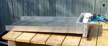

Here is one that I built using a cut to size piece of scrap pool table slate and some aluminum that I bent on my 30" Harbor Freight Brake.
It recirculates into two mixing tubs from Home Depot. The size is 14" wide by 30" long.

Nice looking table! Sure wish I was still in the hvac trade, having access to power shears, breaks, lock formers, spot welders anything sheet metal related would be nice and I could build anything that could be drawn on paper.
So here is my problem, I built my miller table and it works great but not as well as I was expecting. I am getting some fine gold trapped but not this fine (powder) gold that I see in my pans. When I run the cons down the table, I see the gold glittering as it goes down the table but it's not stopping. I'll record a video tomorrow and maybe you guys can tell me if I'm seeing gold or something else. On a side note I adjusted the flow rate, the angle of the table, both and it's just not working, just for the 100 mesh and up sized stuff. Who knows maybe it's not gold...

If your gold washes away with the blond sand it's not gold. Black sand should follow the blond sand and gold should be left stuck to the table after the black sand washes away. Anything that washes away before the black sand is not gold!
Also be sure to use a surfactant in your water such as jet-dry to make sure the fine powder gold breaks the surface tension of the water.
The angle does not need to be too steep (see my photo above) adjust water speed accordingly. Steeper angle slower water. Less angle faster water but not too fast.
