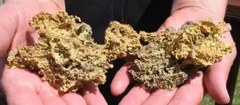

Can anyone here say they've ever seen it or run across it ? Any stories pictures or knowledge you're willing to share? For clarification I am not talking about Eluvial h2o+gravity concentrated pockets but pockets of gold found exploring a lode deposit.
Been exploring a quartz vein in granite country rock. A friend told me he got gold out of it in the eighties with a shaker table. Trenches with a couple short adits, coyote holes and inclined shafts. Not easy to get to and whoever opened it back in the day somehow got an air compressor up there to run a drill. Mineralization is pretty standard for the area (geothite limonite iron layered quartz, iron pyrites). In areas in addition to the quartz and granite there are layers of very soft altered material that for lack of a better word I refer to as chlorite. Very very soft in comparison to the vein or country rock. Coloration is from white to blue to iron iron iron brown (with inclusions of sandwiched iron (oxides, and geothite) to sometimes interestingly enough 'gold' colored. If it's gold gold then it's not like anything I've ever seen or recognized as gold.
Thanks for knowledge pictures enclosed.
Pocket gold 5.webpPocket gold 1.webpPocket gold 2.webpPocket gold 3.webpPocket gold 4.webpPocket gold 6.webpHigh grade gold pockets in Quartz.webp
Some pictures off the internet. Some are hydro formed.
More pictures.
All the rock pictures respond to a metal detector and have visible gold as told by the owners.
Most of those don't really look like "pocket gold" The spongy stuff kinda does.

You can also have ore running many oz per ton with no reaction to the md20 at all.
Id say most lodes have pockets..it could be a geologic feature along the vein that causes more gold to drop out of solution than other areas.
But I do think the ore looks good. Probably not high grade but still has potential.
