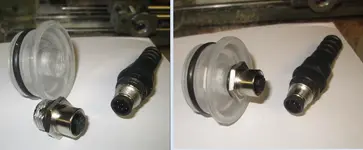

OBN, how hard would it be to make an adapter so Infinium headphones could be used on the CTX3030? I figure if I could get an IP68 plug like you show in the pictures and the female end of the plug that is used in the Infinium I could make an adapter so I would be able to use GG Amphibians meant for my Infinium on the CTX3030 as well. What are your thoughts on this?

Made a few up already...may have one left, have to check and see. And Geronimo your package is inbound Sir....New design on the Skullies..MSA's shells
OBN, I was actually looking to make the opposite adapter of the one in your picture. However, I just ordered 2, 8P MALE M12 SENSOR STRAIGHT SOLDER IP68 waterproof plugs. I suppose I could swap the plug on the GG Amphibians so they will plug straight into the CTX3030 and then use the adapter like you made for using the GG Amphibians on the Infinium. If you still have one of the adapters left, how much would you want for one?
