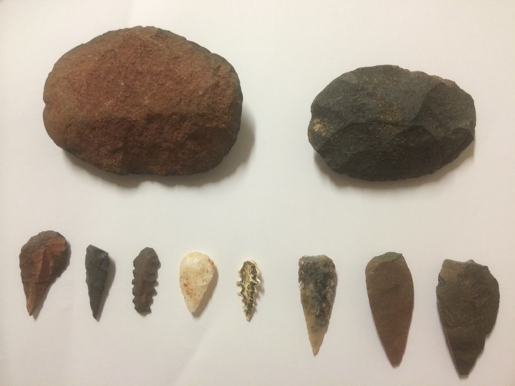

This is a small collection of napped stone indigenous spear points and 2 hand axes - found in West Australia's Kimberly Region, (Around Halls Creek), back in the 1970's when working on a local cattle station as a stockman. We camped often around water holes and often the indigenous would leave hand axes for e.g. where they were so they could use them again next time they visited or their relatives (kids in future) would be able to do so.
Being nomadic - such things were too heavy to carry around on long walks - so it made sense for them to leave a set at each place of permanent water / shelter so that they themselves or indeed someone else could use them when camped there.
You just have to learn how to think like them and look with your eyes... and to recognize stone thats been worked.

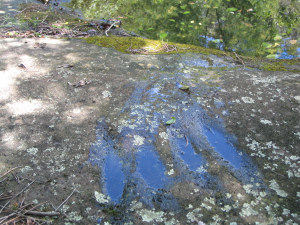

Often if you look in river beds for sandstone you can find slots where hand axes have been sharpened in the erosive sandstone bedrock material.
