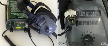

The New Gray Ghost Amphibians for the Garrett underwater detectors blow away the old original Gray Ghost underwaters. SPL for the new is around 92/93 and the old is 66/67. A 48% increase over the old sets. The audio is also much cleaner then the garrett blues and the Koss yellows And the good is you can adjust the audio as needed for the conditions at hand. I have been testing them for about a month now on my Garrett machines and have now installed them on the Excalibur for testing.....
Test between the Garrett Blues and the Gray Ghost Amphibians
Hunt with the Excalibur and the New GGA
compare to the Minelab Koss yellows

i bought the amphibious headphones those ones are the newer ones right
If you got them from Extreme Detecting or Detector Pro, yes they will be the New Gray Ghost Amphibians. The new ones should be here by the first of July. I think the Dealers will have them a little later.OBN0101.webp

If you got them from Extreme Detecting or Detector Pro, yes they will be the New Gray Ghost Amphibians. The new ones should be here by the first of July. I think the Dealers will have them a little later.<img src="http://www.treasurenet.com/forums/attachment.php?attachmentid=813504"/>
Thanks Bigscoop, they are rare for sure.
Got them yupp
