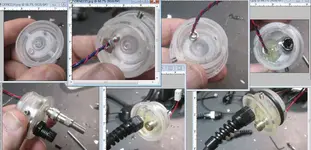

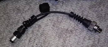

I have made several water proof adaptors for many different detectors, it is just a matter of matching all up to what you need
A few adaptors I have made from the Garrets, CTX, JW Fisher, Excalibur, and a regular stereo plug. The Grey Skullis and a set of CTX waterproof ear buds

Questions what headphones do you use now? And are you planning on going under water at all. It maybe just a simple fix in using the set of head phones you have now and getting a water proof adaptor to adapt them to the AT Pro...Like the one show and I can make the cord long enough where you can tuck the stereo plug into your waders or tie wrapped to the headphones out of waters way.
You sir blow away what little electronics skills I have. I was unaware all the adapters that were available. I understand I am hunting land right now my season has started as well. I will ponder my options and get back with you maybe for some help.
View attachment 1105290View attachment 1105289
View attachment 1105291View attachment 1105288
View attachment 1105294View attachment 1105287
Very nice engineering!
