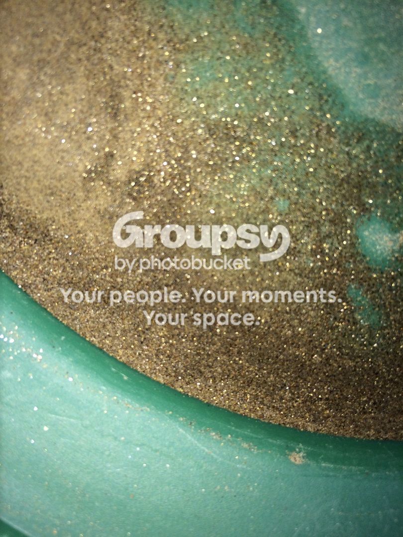

We've panned and panned. The "gold" moves in the pan but it's way smaller than any of the material in the pan. I want to get some 100 mesh or even 150 mesh screen but I'm leaning on the side of not gold and can't justify putting more money into the materials to find more of it.
We have some green chalkboard that we could make a miller table out of for no cost but time and that might help us out if we can get it classified down more I suppose.
He has a couple of isolated flakes that he's trying to find with the microscope but is having trouble finding them. I'll report back if we can spot it.

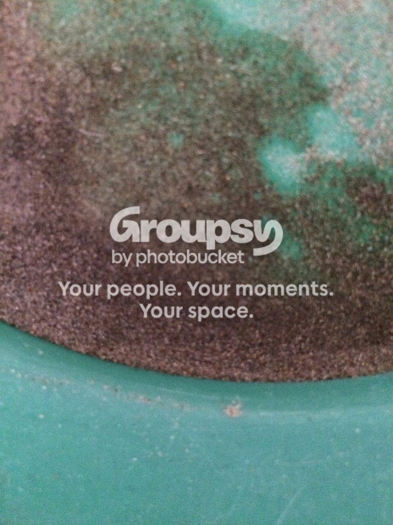

Hey guys. New here. Got a question. My dad thinks he's found gold and I keep tellin him it's pyrite. It shines in the pan but moves easy. Really small pieces of flour. I built a blue bowl to see if it moves like gold or not and the pieces stuck even with water on pretty high blasting all the rocks and black sand out.
He bought a microscope because it's too small to picture. I keep thinking pyrite.

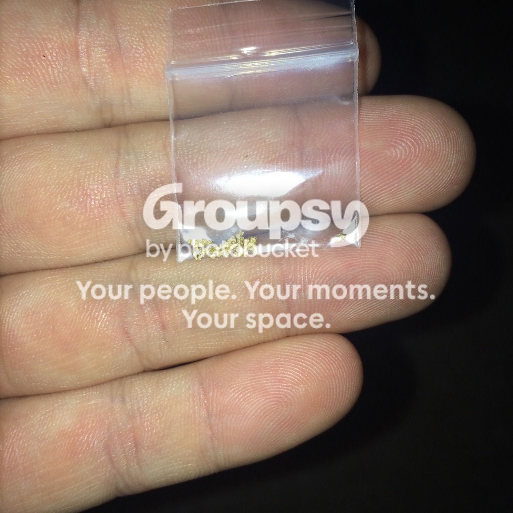

I had that idea too. I bought .1 gram of fines last week and they should be here early next week. It was like $7 for it. I worked a little today with my bluebowl and ended up with flakes stuck to the bottom like it should with my water on full tilt. Good sign. It wasn't enough to grab and pile for a picture but I had some concentrate that was extra we didn't run and I snapped a few pics of it in the pan. One with the flash and one without. It's really a difference under the light so I'm still leaning towards not gold. Here's the pics and I'll report back when my gold fines show up.

It won't let me edit my last post but reading up on fools gold I've kinda leaned towards mica. My eBay gold is supposed to show up Monday according to the tracking number. I'm so skeptical about all this and my dad just sees shine and jumps at the it's gold conclusion haha.
Nathen If you see color only with a flash it is not gold. When gold is in the pan you will know it. Even the smallest of specs will stand out. The key is to get all the junk out of your pan where you only have black sand and gold. Keep stratifying your pan and bleeding off the lights until you get to black sand only. Good Luck in your pursuits.

It sounds like it is mica..gold will float on water tension. I use hot water less water tension with jet dry or dish soap. Then if you swirl the water even the smallest peice of gold will stay planted to the bottom of the pan mica will flutter around. Easier way to tell is if you rub it between your fingers mica will break into pieces or decinagrate gold will not.. I hope this helps you

When you put the material in the water on my bluebowl with warm water but no jet dry there are tiny pieces of gold colored material floating on the surface. Actually most of this color in the pan is from shaking up the bluebowl and letting material dust run out of the feed hose into my pan. It does eventually sink to the bottom of the bowl and the larger pieces dont wash out with high water flow.
There was a bunch of magnetic black in the bowl too so that was a decent sign but I still don't believe it's gold. My stuff will be here tomorrow and I'll try somehow to make it the same size as the stuff in the pan and see how it looks/moves.

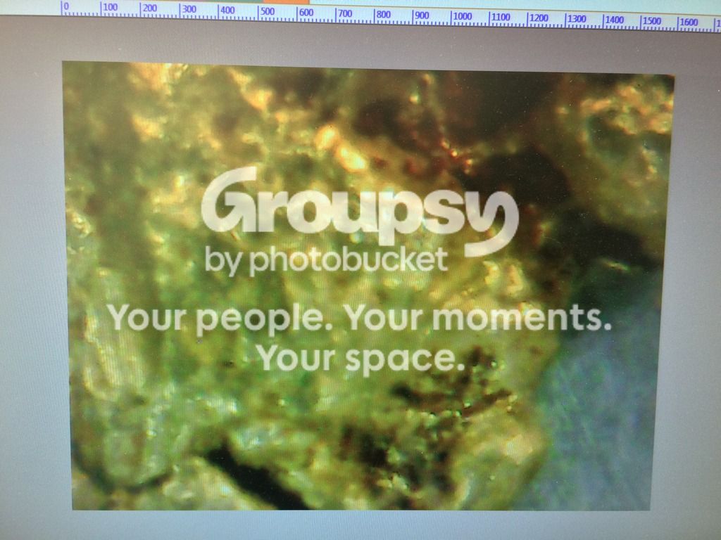

Any help is better than no help and I appreciate it all! My gold showed up and the first thing we did was get it under the microscope. It looked very porous almost like lava rock (my first thought). I can see how it wants to float on the water and man did it want to do that. So after looking at it under the scope and light (100x microscope) I seen bright gold on the stuff I bought but later when we put the golf under the scope it wouldn't show any gold color but only showed silver coloring like some of the other stuff we panned. I dropped one of the smaller pieces in the pan and it sunk right to the bottom fast in the water. I decided to clip a couple of small chunks off it to more closely replicate the sizes of the other flakes in the pan. I could get the medium and large pieces I clipped off to separate from the other material but I had no luck getting the smallest Mose similar size piece to come out of the other material. It was all tied up with the gold colored flakes in the pan. Idk what to think of that honestly. No matter how many times I moved it around I never seen the tiny gold piece stick in the pan where all the other stuff moved. Here is a couple pics I took. Is it just me that didn't know it was so porous lol?

Just as a comparison this is all under the same magnification as the other pictures. The pieces of whatever we are finding are super tiny!

Looks like gold but it may be pyrite.. The final test that will tell you exactly what it is squish it with pliers if it is gold it will smash into a thin piece if it is pyrite it will shatter into tiny pieces!!!
Even if it is pyrite the good news is where pyrite is found there is a pretty good chance that you'll find gold also. It's not always the case though iron pyrite comes with iron ore and gold is associated wit iron ore & magnetite
