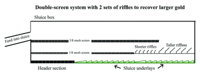

I see alot of people talking about an over under sluice. what is it exactly?

A over under sluice is basically a sluice with another sluice built into the bottom. You need a bigger pump for more water and a bigger sluice for that. Look at keene's 3 stage sluice and do away with stage one and then you have a o/u sluice.
