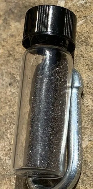

I have a bit of placer gold that I recently processed. The material if from a new claim just south of Idaho Springs Colorado (off of Clear Creek)
So far it’s been through my Big Sluice, Mini Sluice, Magnetic Black sand removed from dry cons before Several Classifiers (most of it is between minus50 and minus100).
Then cleaned out remaining BS with my Blue Bowl.
I’m confident that 99% of black sand is gone. The Gold that is pictured appeared Very Gold while still in the Blue Bowl.
What is giving it such a dark appearance in the jar and how do I improve the brilliance?
I did tumble it for a Cpl hours (not overnight or days or anything) in some salt/soap/vinegar...and then tossed in a little CLR when it didn’t seem to be improving....maybe I need to let it go longer???

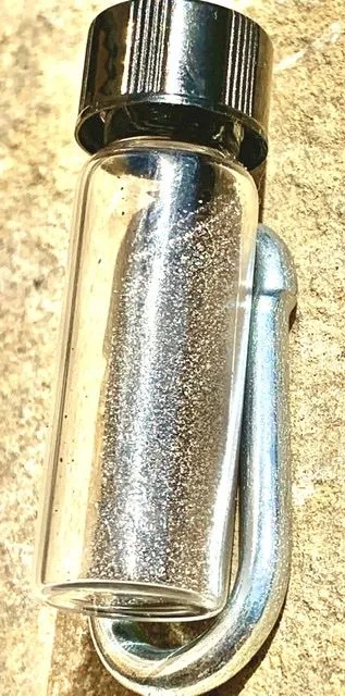

Here are 2 pics. The one where it’s very dark is just a regular un-adjusted pic of the dry gold in the sun. The other pic I adjusted some photo elements to diminish some shadows and black point which really helped to see it as gold.

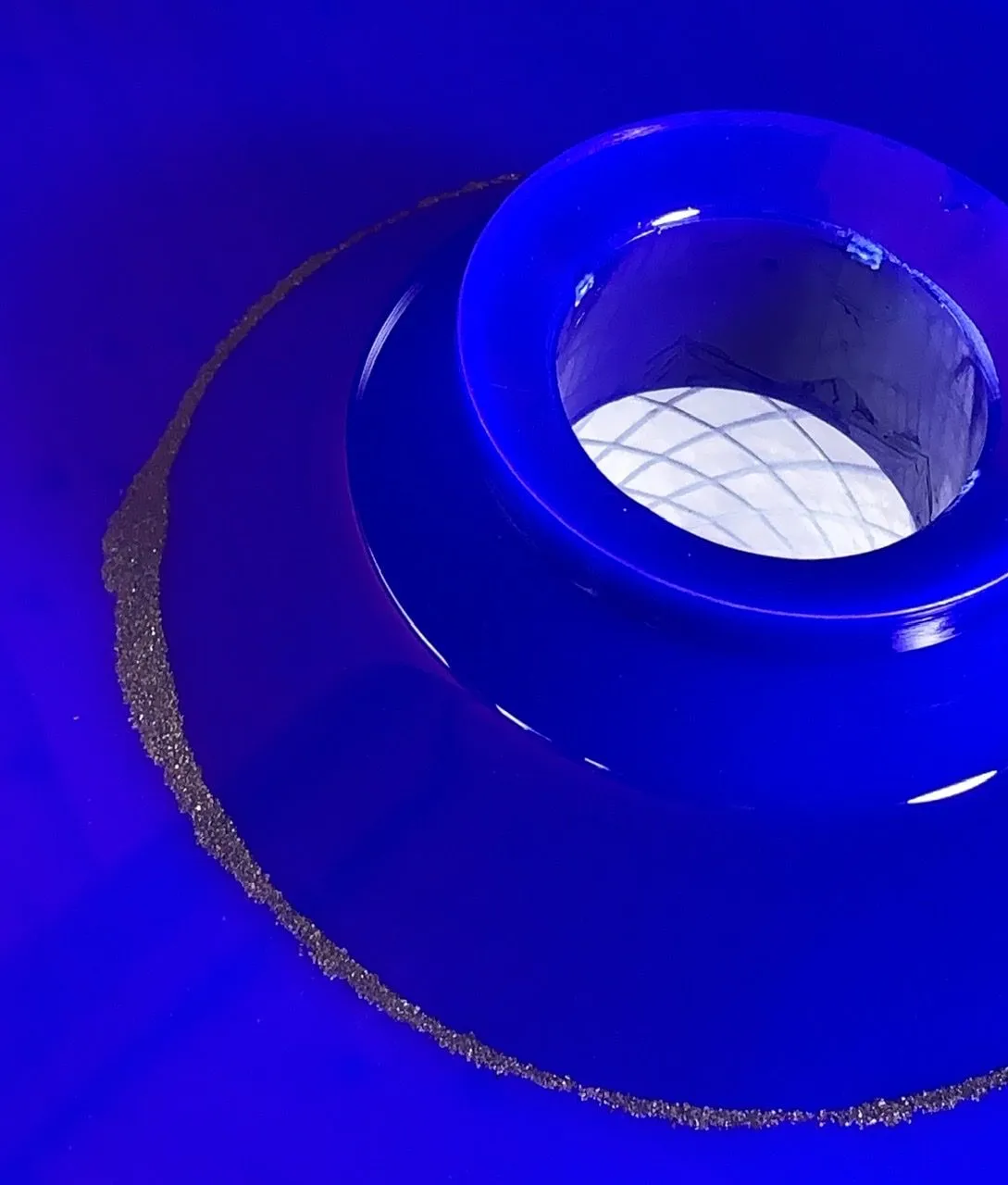

Here is an un-adjusted pic of the same material while still in the Blue Bowl.
At this stage I had already blown the material from the center to the outside several times. ...to the point that i saw no other non-gold material floating or sitting anywhere and the only material flowing out when the water reached level was very very very micro-fine gold.
I thought maybe that part would help if you could see what i was seeing.

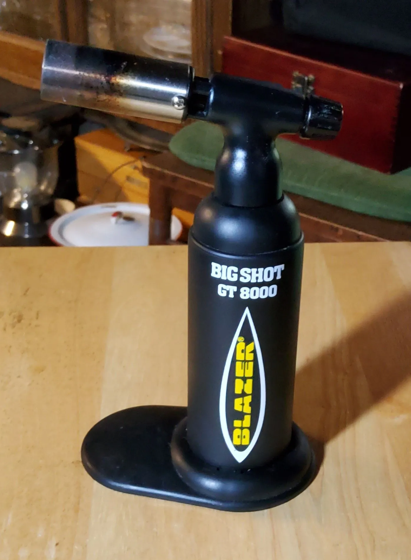

This is what I use to give it the shine
https://www.amazon.com/gp/product/B000NCZU0A/?tag=treasurenet01-20

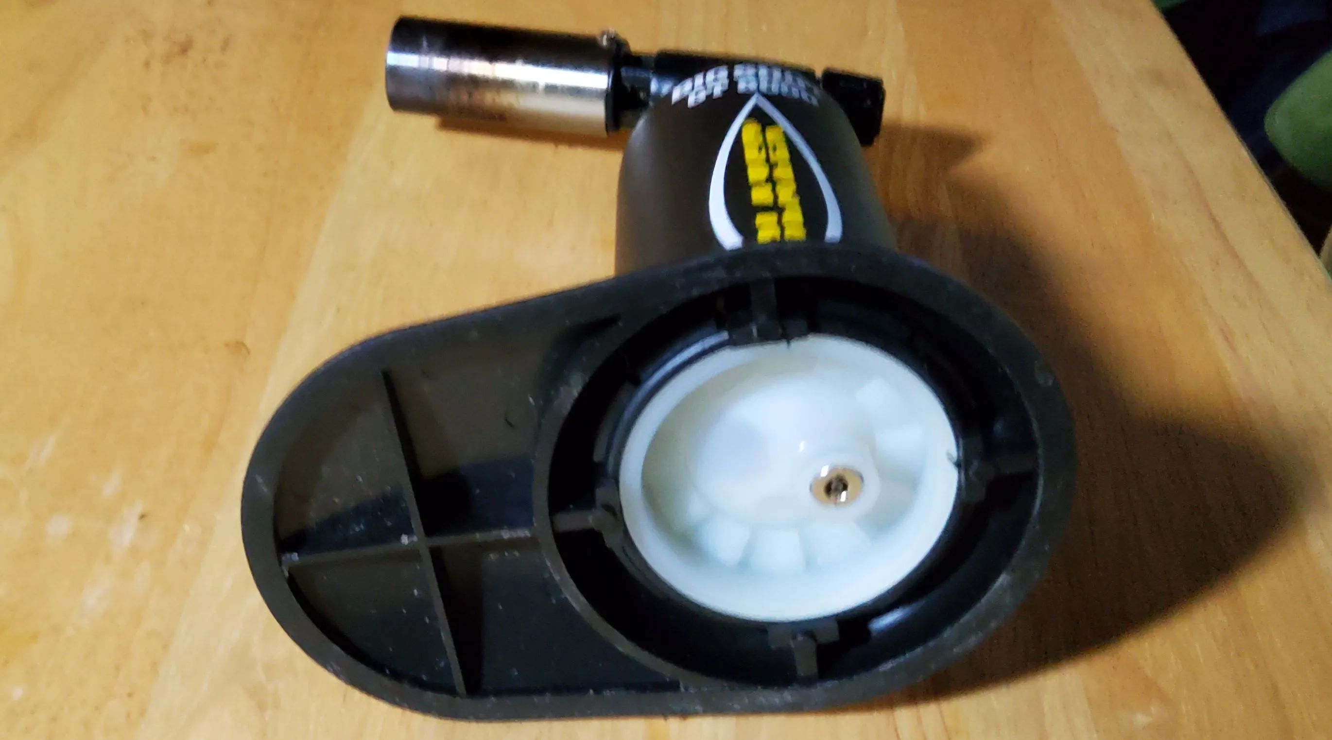

You can melt your fines into a sponge to keep from loosing them and you can brighten your gold by heating it. It had been 10 years or so since I cleaned some nuggets this last winter and they were really dull before I torched them. You are not trying to melt them, you just apply the heat until they start glowing orange and you can watch the impurities burning off.
http://www.treasurenet.com/forums/attachment.php?attachmentid=1844366&d=1593178313
We use food grade butane because we use this torch daily for cooking and torching meat. If you don't like eating the fat off of a steak, torch it until it's a bit crunchy and it becomes the best part. Cleaning gold is just an added bonus. Karen is one hell of a cook :)

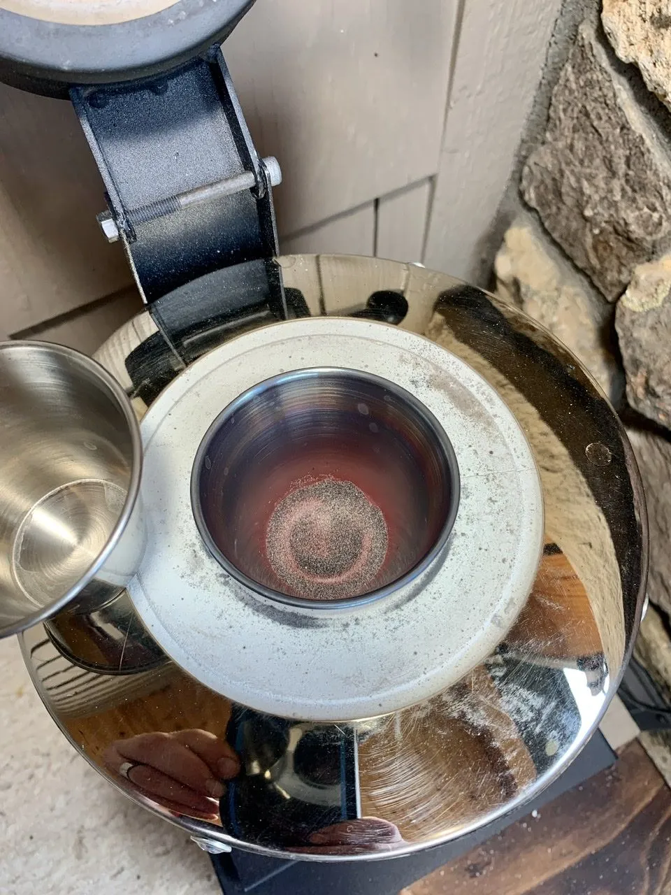

For starters I’m just attempting to roast the fine stuff...not melt or smelt.
I think I need some advice on what I’m doing here though.
I’ve gradually raised the temp on my furnace and am in the 950 Celsius range at the moment.
I’m using a Stainless Steel cup for my crucible. I like the smooth-ness of the SS and since I’m not melting anything I figured it was an appropriate choice...please let me know if it’s a bad idea if I’m just essentially trying to roast this stuff. What temp and for how long?
Nothing but the cup is glowing at this point...I’m assuming I need to get to a temp that’s barely below the melting point?? ...so maybe just a bit hotter?

I'm not understanding why your just heating it... Just take the temp up and then pour some bars. Every time you open a jar of superfines, you loose a bunch. I open it once to make buttons and be done with it.
Super fine gold starts out dull and after you have it brightened, you can fold a white piece of copy paper and then hand separate out the rest of the black sand.
