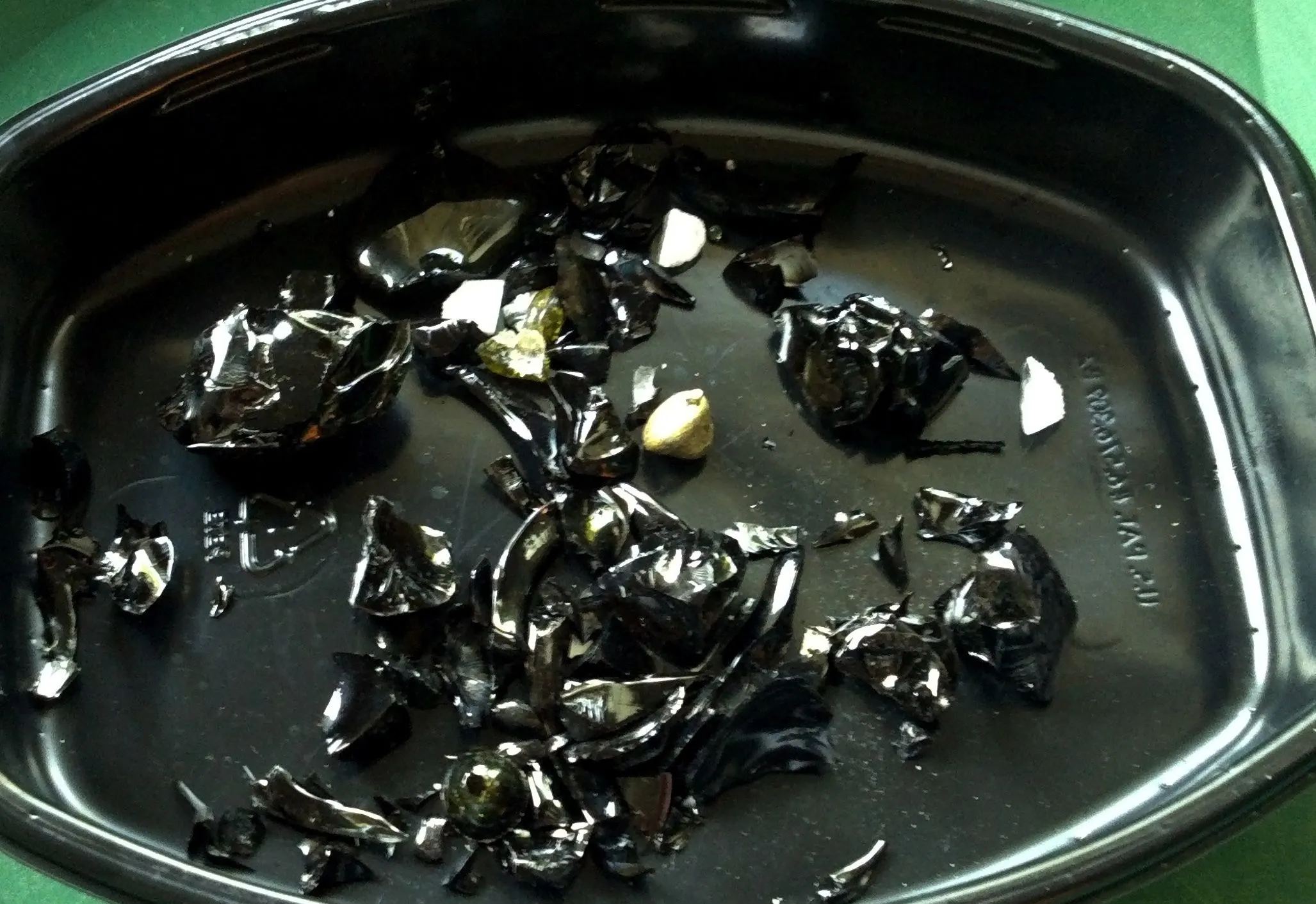

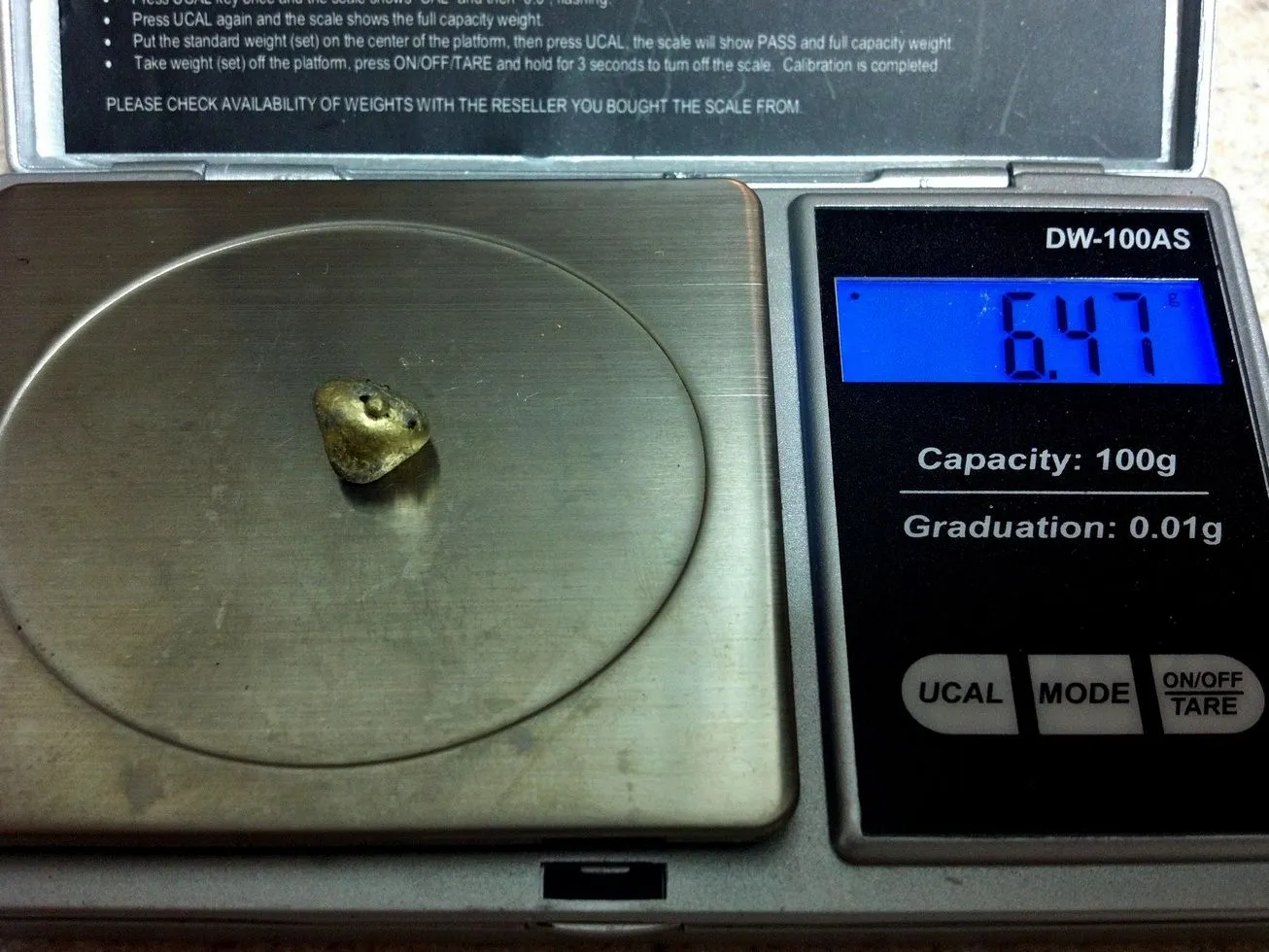

Hello! I've been mining since the 1970's; started out of Fairbanks and have learned from a lot of good folks over the years. Over time, I figured out what worked best for me from most everything I picked up. With that said, I make no claims for it being the "best" or "foolproof"; it's just what I've learned!
Once I get it down to what I call "microscopic gold in black sand"; essentially nothing I can separate or see much color in... I melt it!
Condensed version: I mix the dried black sand with flux, melt at about 2000°F, pour into a conical mold, cool, break black "glass" (melted black sands), and recover the gold "button" at the bottom.
That being said, there is a small cash outlay, some education, and safety to be considered before embarking on this method. It works and it not very difficult. I easily recovered the cost after a few good dredging outings. Geology tells us that the largest percentage of gold is in the "micro" category. Again, I make no promise, but in my case, I have been significantly surprised in what I have recovered from "invisible" gold in black sands. If you have any interest, let me know and I can share more. I fully understand this is not an option for everyone; just sharing.
Attaching a couple photos... I cannot remember how much black sand this was, but I'm thinking around 4-6 oz. I was amazed at the weight of that button; way more than I expected to see!
Thanks for sharing this info!
I've been saving a lot of the leftovers of my black sands do something like this eventually. Once you make that button, what do you do with it? Are you able to sell it as is to a refiner?
The other part that is always a curiosity to me is how to determine what's all in that button. I've heard you can also find some PGM's hiding in those black sands.
Our GPAA club here in Missouri recommends that you melt your fines (Not your nuggets ) down to 1 gold button BEFORE sending in to be sold. Now you know the weight of this but you still don't know the purity of it yet, that will be determined from the smelter after it is remelted to determine it's true gold weight !
