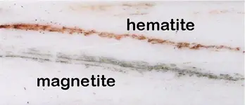

Try a streak test. Hematite should have a red to red-brown streak while Magnetite should give a black or dark grey streak.
OK. First, I showed the wrong picture of it "before." The correct one is below (color is a bit off...actual color was closer to the one below it. Second, it left a gray streak...but that rock looks nothing like pictures of magnetite that I've seen. Also attached below is another I found nearby that I have NOT put in the tumbler. Similar appearance, and the same grey streak.

They both left the same gray streak. I've read that iron slag tends not to leave a streak. Is that true? If it is, the only other thing it could be is magnetite. I did some more research and *have* found some pictures of magnetite that have a similar exterior to mine.

You're right about slag "Tending" to not leave a streak because the majority of metal slag used and found in the U.S. is steel slag or crucible slag, and almost to about all steel shouldn't leave a streak. Weathered steel shouldn't either. Could've been from the oxides on it before the tumbler. My knowledge.

The polished one easily left a gray streak as well...

Yeah, Red Coat, I came over here to mark as solved. I think the fact that it polished up to look almost identical to your rocks, and the fact that it still easily leaves a gray streak points to Magnetite.
