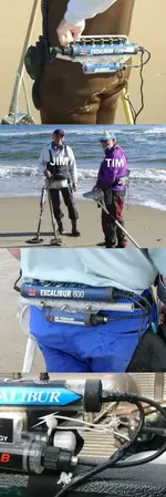

max

more

Max,
As it is often said, "A picture is worth a 1000 words", thanks for posting the pictures. Being an O.F. I really think the neck mount would be best for me as well. This is a great board, I have learned so much.
..Tony

Great pictures Max. My chest mount hangs straight down with the wires on the bottom instead of sideways. I am going to have to get son to take a pic of mounting.
