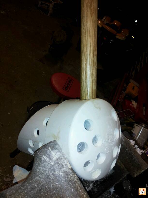

Hey everyone, I am half done building my on the cheap sand scoop. I will be adding more holes and polyurethaning the handle. What do you all think so far?

Dram,
It looks a lot better than the one I made from a cat litter scoop, one thing I did was to rivet a piece of heavy gage coil stock to the front as a cutter blade. I secures it tightly to the front inside lip. But your's looks stronger with the PVC fitting. Great job.....Gary
Thanks Gary, I am trying to keep all metal out of the scoop so I can pass it under the detector to see if target is inside scoop. After cutting the 45* angle to the front I used a half round file on the inside to further sharpen the leading edge.

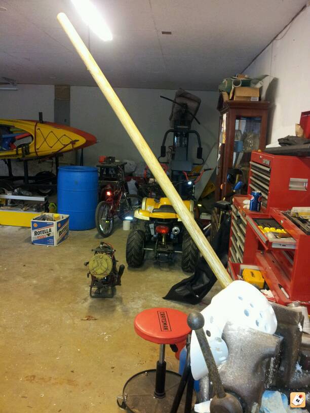

Some updated pictures...
Your going to need to reinforce where handle meets scoop, look at professional scoops....
Sent from my Galaxy Nexus using Tapatalk 2
I was wondering about that. The handle goes all the way through and sits in a bored hole on the other side and immersed in resin with west system 404 mixed in. The handle is oak as well. I will add a brace to it...

Good looking scoop. I never thought about using PVC before, now you got me thinking.. :icon_scratch:
Nice job. Hope it works for you.
I made one recently out of a exhaust pipe the bigest thing I found after useing it was I needed to lean the handle back. With it straight up and down it was really annoying trying to foot it into the dirt.
I leaned mine back as far as I could and keep the connection strong. I can see what your saying though.
