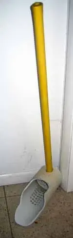

Hi guys,
I build myself that sandscoop out of a 4" PVC Pipe and a heavyduty Fiberglass Handle that I found in the trash. It works pretty good. Great in dry sand good in wet sand, but not big enough for the surf. Sometimes I have to dig over ten times because the waves fill the hole back up. In dry sand it takes 1-3 digs and in waist deep water 3-5 digs.
