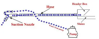

Thats a great diagram of a dredge. If the pump is a 3 inch pump and hose, what size should that bigger hose be? Or could it work ok, if the 3 " pump hose is reduced to 2 inches, and then use a 3 inch hose for the bigger Lift hose? Also about what size is that smaller pipe that curves back to the lift pipe?
Not that simple Capt................
A lot has to be taken into consideration. Pump size is one thing, the motor to run the pump is another. Whether you use a suction nozzle system or a jet system is still another.
The diagram shows a suction nozzle system...... so lets say for instance you want to use a 3" dia. suction hose. You will need a 3" dia. suction nozzle. They typically come with a 1-1/2" pressure pipe with a hose adapter fitting for a 1-1/2" hose or a 2" hose. So you will have to reduce the pump output to fit either a 1-1/2" hose or a 2" hose.
The longer the suction hose and the deeper you dredge requires more "lift" that's where the horsepower of the drive motor and the efficiency of the pump come into play.
