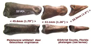

Golly, fellas . . . I'm in Florida where we don't get elk bones; but, I think that this must be an elk medial phalanx. I say that 'cause it's not a bison toe bone and it's not a horse toe bone.
I can provide an image of the toe bones of another cervid, the white tail deer, as my best evidence. (Bison toes in the 2nd image.)
deerphalangesB.webpbison_med_phalanges.webphorse_equus_phalanges.webp​
I think you may be right H.P.

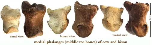

Uh-oh! I see the confusion here. You have mistaken elk toe bones for bison. Trust my images of bison toe bones. Proximal toe bones do not much resemble medial toe bones in these species. Notice the similarities between the deer and the elk bones, the nearly bilateral symmetry (because they are both cervids). Bovid medial toes are not so symmetrical.
bison_phalanges.webpbovidtoebones.webp​
I would tend to agree with your assessment of Proximal similarities, I was referring to the similar characteristics between Cervidae, proximal, and Bovidae, medial, phalanges. The distal end of the bone in question just doesn't look like a match to any hoof core, in my opinion, and yes, I do trust your images, they are always 'top notch' by the way. Maybe these images will help illustrate my point.
