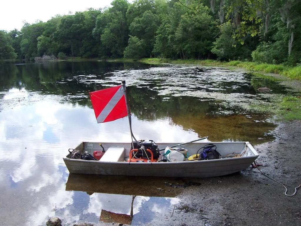

I have a HookaMax and they are great units. I don't use the inflatable that is included.. instead I keep it in a 10' boat (for shallow walking-to spots) and put it in a 14' boat to travel farther. Pic is 10' in the Santa Fe River in FL.
~Mike
Hey Mike, what is the vis like on the Santa Fe?
Imagine diving in Folger's coffee.. with a LOT of current.. :-)
~Mike
P.S. Hopefully, this will change soon. Normal conditions are 50'+ vis
