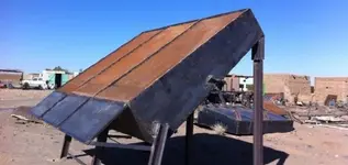

This is the type of drywashers used in Sudan these days , they sell like hot cakes :3barsgold: . Those are large blower type , and need to be fed with a loader or a backhoe. Larger Drywashers produce in average 40-50 gram per day, depending on the ground and gold type. Smaller units produce between 4-5 grams per day. All units are a modified copies of store bought units.
They cost around $12296.87. for the larger ones .
