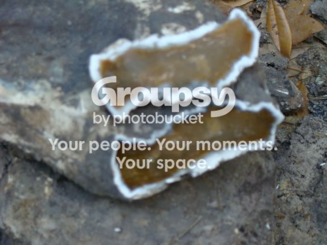

These I dug up at a site here in Hillsborough county on 301 near the river, these were all made from Hillsborough river basin chert, which is a brown chert, its a compressed algea formation with inclusions and fossils in it.. They are all white patinated but if I was to soak them in Mineral oil they would have their color back
