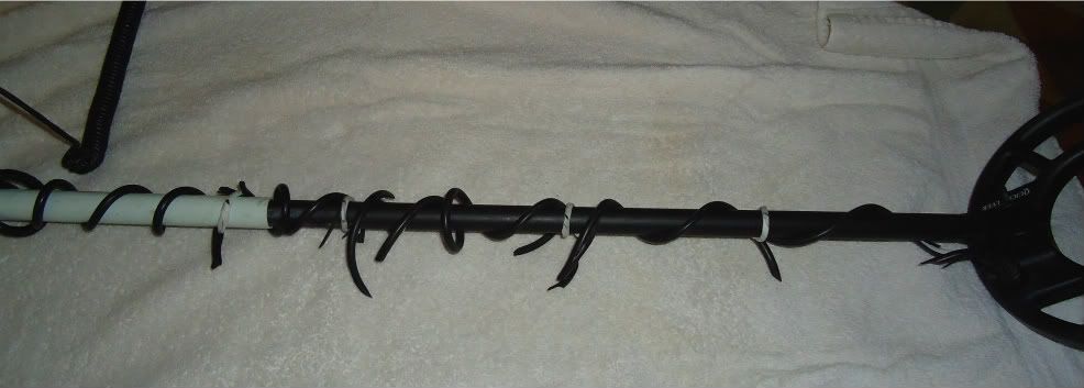

Maybe my deal just went South! I wrapped the coil cable around the shaft last night and put the detector in the car. I thought I might give it a few swings to see how it worked. This morning, when I got to the site, I took it out and the cables' rubber sheathing came apart in about thirty places. I guess it dry rotted from non-use. Used it anyway, in the default settings, and seems to work pretty good. I just downloaded the manual and gonna do some reading. Don't know what it's going to cost to get a new cable put on the coil and on into the box. Anyone ever paid to have that done? See if I can't post a couple pics later this evening.

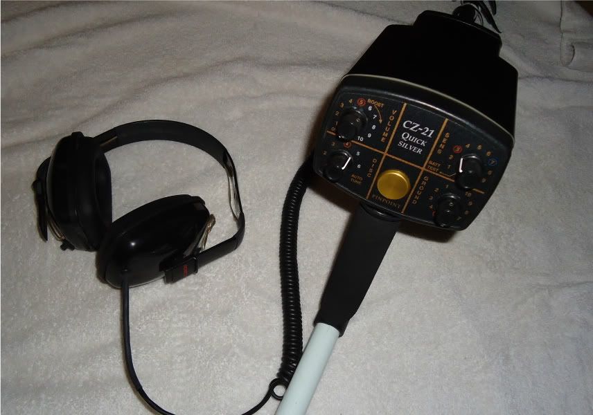

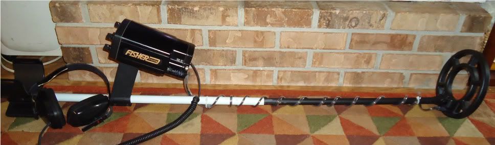

Pics:

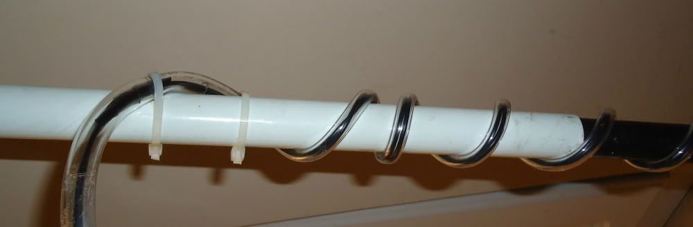

Due to fact that I don't do any underwater detecting, scuba, I was thinking of cutting the coil cable, removing the old rotted cable sheath and using plastic tubing for the outer sheath. I would solder the wire leads and RTV both ends to seal the water out. Any constructive opinions?
Re: How Lucky Does It GET? CZ21 & Minelab Xtera-70 $75!!
Go to the local electronics store and get some heat shrink tubing. I've bought it in lengths up to 4ft. The marine grade has a melt liner in it that completely waterproofs it. Just remove the cable connector, slide on the heat shrink and heat it to shink it, overlap it if its not long enough. Cable will be a little stiffer than the original, but still wrapable. Worth a try anyways..
Think I might try using clear tubing, the sort used on aquariums. This will make it easy to wrap around shaft and will allow for mounting the box on a belt. If I ever have the need to sell it or want to use it for underwater use I would most assurably have a new coil mounted and pressure tested.

I opted to use clear plastic tubing and run the original wires up thru the tubing. I removed the coil wire nut and siliconed real well under the nut to ensure that no moisture will seep into the coil. (I hope!) I will make my soldered connections by the control box, about 8" out of the box, and seal as I did on the coil. Just got finished sealing the coil end and should be dry in about three or four hours. Gonna take some pics today and post later for those interested. As second insureance I think I might try some of that "FlexSeal" on both ends. Looks like it's gonna work pretty good!
REPAIRS COMPLETD.
