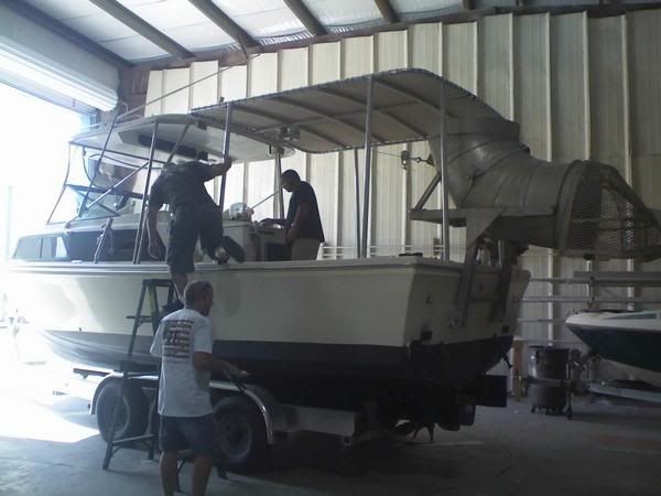

This is a mailbox Fisheye put on the back of my boat. You can see the swivel point on the back of the boat which allows it to swing 180 degrees so that it covers the propeller and allows it to redirect the prop wash straight down. The force it generates is quite impressive and can actually lift the stern of the boat. This particular boat weighs 12,000 pounds.

basically its just a tiltible metal cage the goes behind the ships prop area and deflects the prop wash towards the bottom -- the size of the props and the speed their run at will of course affect how deep and how strongly they will reach downward .
run slowly --check your holes often -- no divers down while prop washing (for safety reasons) -- of course log what areas you do and what finds you find in your scour holes.
word to the wize. ---due to the high stress put upon it by the prop wash --it needs to be made strongly -- not cheaply
