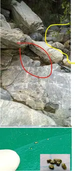

The pic here shows what I sampled (circled in red) and the "specks" I got. The Yellow area is what I came back for.

This is the area the second time around after I cleaned up the bedrock.

The later bedrock pic was taken before the washing.
and pics I took of cleaned bedrock were blurry from water on the lens.
quite a few shots like that actually - arg.

Nice looking spot. I did not realize you were sniping bedrock in my earlier comments. First thing I notice is how smooth some of the actual bedrock is, which does not make a good gold trap, but the place you were sniping looked worthwhile. The thing about sniping is sometimes (most times) a really easy and obvious spot has been done many times before, even in very remote locations. My advise (because there is gold there), is to move around a little bit and try to get into a deeper crevice on the gold path and see what it produces. Especially look for places that are hard pack (somebody else had not cleaned it out recently). Good luck.
in areas that have smooth bed rock that are in gold producing stretches, work every crack and drop you do find. Just because its smooth doesn't mean gold doesn't move through. And when it does the gold riding along the bottom will drop and catch where it can. Also smooth bedrock still has cracks many have been pounded and closed up by years of abrasion. look close
