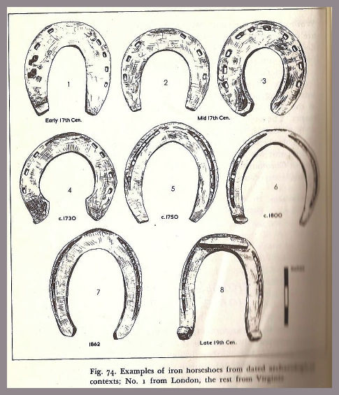

Dating horseshoes is darn near impossible.
Would it be better if I got the rust off?
The problem is that you can only get broad date ranges, even then it's not always accurate. Horse shoes were hand made for each horse. Different people had different techniques. So styles and shoes varied greatly, usually making it hard to pin down dates.
I pulled this from another TN thread - this is just one of the replies in the thread...
The information that was provided was found in the book: Artifacts of Colonial America by Ivor Noel Hume. (Don't shoot the messenger-call the author!) As noted, dating horseshoes is difficult at best. As with any hand-made item, the maker has the liberty to make it as he/she wishes. A current gunmaker could easily produce a flintlock rifle with all the early fixtures, but it obviously would not be old. Same thing with an ancient spear/arrow point. All one can do is go with the professional studies that have been documented and make your best guess.

Not really. Doesn't make much difference. Hand made horse shoes are still used today, not as often as in the past, but nothing about a horses' foot has changed in a thousand years, and the need for shoes on horses has existed since the first man figured out how to ride a horse.
On the chart posted by VP Navy, shoe number 8 is a mule shoe, and I have nailed on lots of those shoes when I was younger and dumber. 5, 6, and 7 are corrective shoes, and if the horse needs that style of shoe, a good farrier will make one today. I've built shoes just like number 1 for the back feet of a show horse that the owner wanted to have the horse slide to a stop. Almost impossible to date a horse shoe unless it's found with something that you can date. Your find was left on the horse way to long, and the shoe wore in two at the toe. Either that, or they were in very rocky ground that caused it to wear faster than normal. Your shoe has also been cut off square at the heel, which isn't the normal way it's usually done, so I would suspect it was either for a back foot on a small horse or pony, or possibly a small donkey or a smaller size mule.
