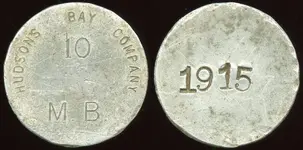

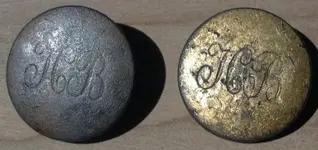

This next variety is not from the coat-of-arms.....
Very problematic indeed! I understand the author's skepticism as the HB mark is the most faked but the rarest occurring mark/design.
Most of the "HB" items out there on e-bay have the two letters almost together with a straight lettered font.
If you look at my button, you'll see spaced letters with a fancy font. Totally different than the usual HB mark you see out there.
I've found two coat and two cuff examples at four different sites but know of others found by fur trade hunter's in three different provinces and one state.
Up to three different back marks between us all.
Outside of this button, I have only found an H B (spaced) mark on a late 18th century scalping knife, otherwise, no HB on anything else....Ever!

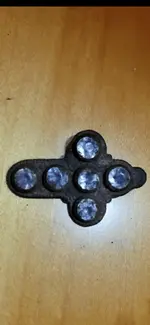

Also my buddy found a cross trying to find any info on them. Any help would be appreciated.

I found one of the buttons in this article but would like to know the approximate age. Any info? View attachment 2112564View attachment 2112565Also my buddy found a cross trying to find any info on them. Any help would be appreciated.View attachment 2112569
