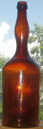

It was raining here today so I was going through some of my boxes of uncleaned bottles. I have always loved this one I just haven't got around to posting it. It was found here in Texas in a dump from the mid to late 19th century. I can't find anything about it on the Internet. The base has a diamond with 219 inside of it. The mold seam stops before the lip. I think a lipping tool may have been used. Also it is 12 inches tall. Thanks everyone. HH

Thanks. The neck is the main reason I want info on it. I thought it was pretty unique. Thanks for the comment. HH

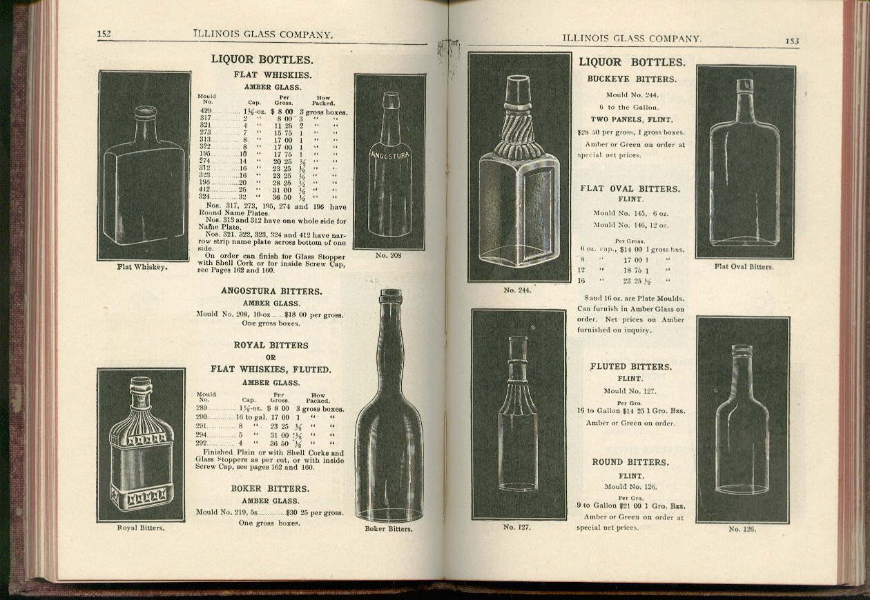

I can't believe it but I solved this one myself. It is a Boker Bitters bottle made by the Illinois Glass Company. I found it in the 1906 catalog.
Also, if it interests anyone, this bottle's design is called a Lady Leg. Thought that was interesting.
Yeah it's a later bitters, earlier ones had this style lip instead of a crown top. They came in some nice colors and many are embossed and some bring huge money in the $5-6000 range...
Thanks for the comment. It looks like mine if mine wasn't so chipped and still had the label it would be worth 50 or more. It's probably only 5 or 10 in its current shape but I really don't expect to make money off this hobby.

I've never had the honor of diggin a ladys leg,have owned a couple in the past,but must say,thats the first crown cap ladys leg I've seen.
Interesting. I wonder if it is somewhat rare. I would just want to know for myself. I've sold very few bottles and they were doubles in my collection when I did. Thanks everyone. HH
My first, too, Charlie! There's something cognitively dissonant about the combination of features. Anyone have another twentieth century lady's leg bottle to show us?

Are you saying that mine is from the 20th century. Upon close inspection it really looks like the seam ends before the lip. I am just an amateur at this hoppy though. Thanks everyone for the help.

Hey Josh,
I've never seen a crown cap lady's leg either. Nine chances out of ten, it's an early 20th Century bottle. The "216" in the Illinois Glass Diamond is the mould number. I believe the IG Catalog is using "Boker Bitters" generically for the style of bottle.
Illinois Glass Co. 1906 Catalog
You'll notice the 1906 catalog shows a champagne finish on the bottle. If you read the SHA site, Bill Lindsey sez that the lady's legs were often used for various spirits.
