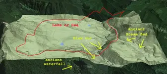

I have been evaluating a certain area and after much study I arrived at a rather interesting conclusion. The short version is that the area I am prospecting. A steep, mountainous canyon. Used to be an ancient inland sea or lake. This is supported by the fact that I found a fossilized dolphin bone in a boil hole in the creek at the bottom of the canyon and the following images.
This is the basic Google Earth image, nothing too impressive. The original question haunting me, why is there a flat spot when everything else is mountains? But a couple days ago I noticed the ancient waterfall front and center in the image. "What the hell is that doing there"?, I asked myself.
I was also working on looking for high benches, so I created an overlay for the area of interest. Now I noticed a "bench" running the entire perimeter of the flattened area at about the same elevation, with the exception of a massive missing section where the current stream bed is. The "bench" height coincided not only with the ancient waterfall I had observed, but also with the strange ancient river course through the woods along the road that accesses this area on the right. That old stream bed in the mountains has always intrigued me. Now I can see that it used to be the drainage for this ancient lake.

This also coincides with the geological map of the area to some extent.
Now the part I don't know is: Does this help me at all with finding any super enriched gold deposits? I do not believe the gold was exposed until the violent uplift of the ridge which split the valley. I hypothesize that the force of this uplift created the hydraulic pressure that created first the waterfall and then blew out the entire canyon wall and drained the lake/sea. Without getting too far into it this event would coincide with the massive destructive event approximately 45 million years ago 'geologic time' (12000 yrs. bible time). So I'm not sure that the lake actually existed in the time that the gold has been exposed to weathering.
My observations coincide with 1977 evaluation of this mining district as to the descriptions given of the ore bodies and the alteration state of the vein emplacement and heavily altered host rocks. Showing both hydrothermal emplacement and high temperature alteration of the original material.

Uplift of mountains over time is something that a lot of miners never think about. Most never even try to think in geological time, erosion, uplift and they should. The grounds we hunt haven't always been as they are now. Between glaciers coming down from the north and the Pacific Plate running smack dab into the North AND South American plates a lot has changed over the years. This subduction zone is the miners best friend! If it wasn't for it, there wouldn't be near the amount of gold out there to find in the western states. Learning about the paleo geology is important if you're going to be more than just a weekend warrior. How the mountains formed and the gold got deposited in them is cool to learn. The majority of the big deposits are found in the north/south running ridges that were pushed up by the pacific plates movement under the North American one.
I think you're on the right track and should be able to answer your question on your own in just a short time. Keep working on it.
looks like a lava dome that caved off to me. get out there and explore dig lot of holes
zoom out from here 46.400116 -121.817295
Why would you think that was an "ancient" waterfall?
Unless you can give logical answers based on the geological history of your area those are just ideas you have, not a discovery.

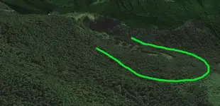

For instance what you believe is an "ancient" waterfall looks exactly like a rotational slide:
or possibly partially an earthflow, see the characteristic hourglass shape?
You might find another reason the earth slumped there but none of those reasons are going to be "ancient". The "waterfall" you see is clearly a recent geological phenomenon that was not caused by surface water erosion. Study more on why the earth moves HERE. I think you will see my point.
Most if not all of the information you need to discover the geologic history of your area is freely available. That landslide probably has a name and a time frame already pinned down. There is no need to reinvent the wheel. With a little searching and study time (research) you will find that most of your questions are already answered.
I hope that helps. If you care to share where your area of interest is I'm sure I could point you to some information that would help your understanding.

Thanks for your input Clay. I'll explain my theory and answer a few of your questions.
My hypothesis is based on my observations of the surrounding area. Observations made on the ground and through areal photography. Here is what I see that supports my waterfall.

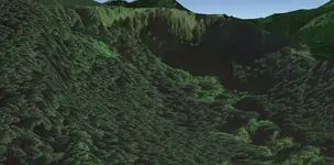

From this angle no debris pile is visible below the rock fall/ waterfall area
These two images show the area above the fall. The 50 foot tall cut bank to me looks to indicate an extensive scour zone. I have not been to the area yet. I plan to in the spring. I expect to find evidence to support that this area was scoured by a large volume of water. I do not 'know' that I am correct. This is just my initial observation.

Now in support of your assertion that this is only recent subsidence I looked from a wider angle than before and did find that the recent fall material is still in place and may be a result of perhaps the 1700 quake. I maintain that both could be correct. That the existing wall collapse may have occurred much more recently. I maintain that a massive volume of water passed this way. All the mountains in this area hard enough to resist erosion show water wear on they're surface. Smooth and rounded, to great elevation. Unless the faces have collapsed.

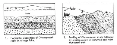

I also did some more searching due to your prompting and did find this
I havn't read the full report yet. But it does support the lake theory.

It looks like the 50' wall is actually a fault escarpment, a fault would be running at the bottom of that 50' escarpment. Evidence of a an old lake should be fairly easy to find, a lot of very fine mud and silt from the lake bottom had to go somewhere if there was such a cataclysmic event. As far as the ancient stream bed and waterfall, look for rounded cobble, find it on bedrock and sample it. If the blowout is on the southern portion of the map, I would assume the water from the lake would flow through the blowout to the south, which would not cause any gold deposition in the northern portion of the map. My two bits.

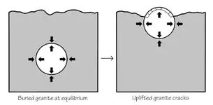

Let's start with the basics. Those smooth rounded mountains are composed of granites. Granite exfoliates in round forms due to the releasing of compression forces within the rock. All those smooth round rocks and mountains are due to the process of exfoliation. Water forces have little or nothing to do with the form granite erodes to or the rounded shape of the mountains.
Here's a diagram to help you understand:
Read the article HERE.
HERE is a link to a video showing granite exfoliation in action in real time.
Get an understanding of the basics and then you will understand why what you are seeing is indeed a landslide. Waterfalls in granite and basalt mountains are the result of landslides or block faulting.

Your "waterfall" is higher at the lip than the surrounding area so obviously it wasn't created by water erosion. Your "cut bank" is clearly the scarp at the top of the uppermost slump block of the landslide. The curved rotational aspect of the landslide is seen in the form of the top slump block that you are calling a "cut bank". You can see the same curved effect in the earlier diagrams I posted.
