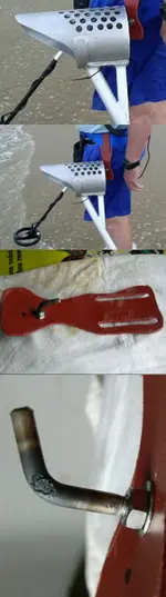

DRAG IT

On the scoops I make, I weld a "D" ring under the grip to clip a dog leash to..... or you could get a surfboard leash.....whatever suits your fancy. To modify your scoop, go to a hardware store and get a D ring big enough to allow you to add it to your scoop handle. Drill a hole thru the handle below the grip, spread the D ring open and then squeeze it back together into the holes you drilled.
Run the leash clip thru your belt loop then thru the loop on the handle end of the leash. Attach the clip to your scoop and it allows you to drag it behind you.....well away from your detector. Plus it makes a track in the sand to show the line you have detected, to keep you from detecting the same sand twice.

Looking at your pictures, that would be too close to my detector. It still detects it, even UP.
brian
i do not know what to tell u then, i have sovereign, excal, and exp II - with w o t and it ...............neigher of these machines detect my scoop.
