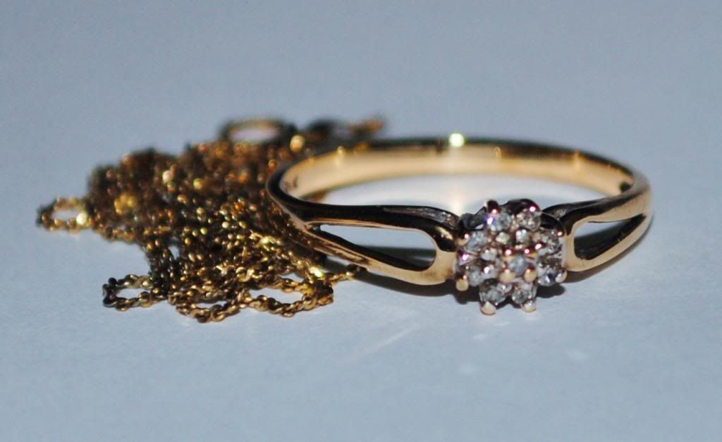

I have been doing some of fieldwork recently testing the new Garrett ATX metal detector. It was used both on land and freshwater. My initial thoughts on the new Garrett ATX PI (Pulse Induction) metal detector were quite remarkable. Now I have been using the Infinium (also a PI) since 2007 and also used the Garrett Sea Hunter Mark II for some time. They have each rewarded me with lots of gold/silver rings, jewelry and lots of coins. The new ATX is a much improvement over the Infinium. I was amazed at how well it responded to tiny conductors. Many a 22 shell/bullets and small buckshot slipped through my water scoop holes, located from decent depths. Using the 12" coil, it also responded well to various chains which I also dug from the fresh water lakes. I did manage one thin gold chain, the one shown below beside the gold ring.

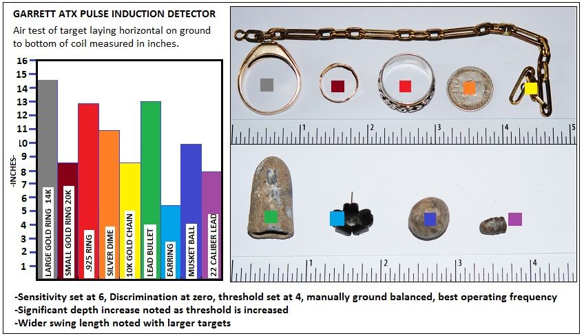

I also noticed an improvement in depth using the 12" coil on the ATX compared to the Infinium using the 10" x 14" mono coil. As my initial experience several years ago, going from a VLF water machine to a PI, I discovered a whole new crop of rings, coins, jewelry and also junk that were now available to me that other people using VLF detectors just could not reach. I had a record year that year using both my Infinium and other VLF water machines. Now with the ATX, I also ran into a similar scenario. I again found a new crop of coins, rings and junk at even deeper depths then the areas I hunted using my Infinium. Now in all honesty, the new crop was not as fruitful as when I internally used the Infinium, but the improvement was definitely there. I had to wait until the swimming was over for the summer to hunt most of my water locations, as the holes I had to dig with my scoop were very deep, and no matter how hard I try, I never seem to be able to get those deep holes filled in completely, so I opted to wait.

Above is my initial depth test done in my backyard in motion mode. The results are partially flawed, in that I had to deal with a lot of unexpected EMI and could not operate the ATX above a sensitivity of 6, (max @13) otherwise the target audio got lost in the EMI audio. Out in the field however, I could easily run the sensitivity near or at max with the detector well ground balanced and running with auto track turned on. And similar to the Infinium, the higher the threshold is set, the deeper the target can be picked up.
