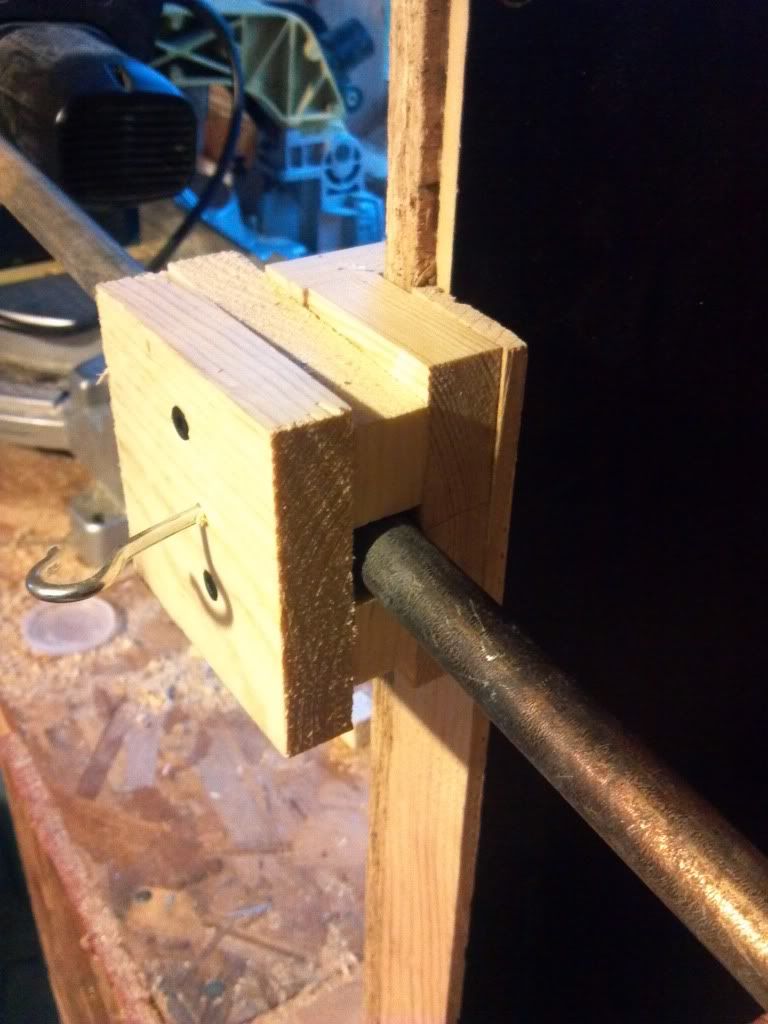

If you want to make some inexpensive but strong legs you can use scrap metal like these
Or something wood like these
