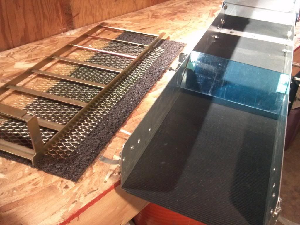

I live in western oregon. I started mining this year. Bought an A52 a few months ago. I've heavily modified it since. It works good stock, but works better for me with the changes I've made.
You always want to find color in your pan before bothering to setup the sluice. If I find 4+ colors in a single prospect pan, then I'll contemplate setting the sluice up.
I live in Northern California/redding area. I was thinking about building a stand for it, so I don't have to play around to get it level in the stream. I haven't found any at all but I know people who have in the same creek. I'm also thinking about replacing the carpet with moss and putting v-matting under the moss. I don't know what other modifications I could do with it
Legs are very important. Miners moss with v matting under is very helpful, but not essential. I added an extended stratification slick plate to mine, separates materials by weight before it hits the upper matting.
But it's far more important to find the gold with a pan first. The sluice just helps you process material faster than a pan.
What is the point of the blue wall??? That's what i wanted to do with the v-matting though and I have some extra
The blue things are just translucent plastic plates that connect the leg brackets. They make the sluice very stable and rigid.
