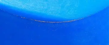

You should be able to pan it out if you are persistent. This picture shows some of the smaller than 100 mesh that I got out of a Gold Cube cleanup (just dug some sand at Clear Creek Colorado that had a streak of black sand running thru it, right at the surface - note: this gold would have just floated away if run thru a normal Sluice). My guess is there are 250 to 500 specs here. It took patience to separate them, but classification screens and a magnet in a plastic bag to pull out the magnetite helped a lot.
Processing a few shovelfuls of surface sand was a test to see what the Gold Cube would pull out. I doubt what you are trying to get out is any smaller. Used a snuffer bottle to remove the gold from the pan.
