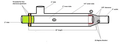

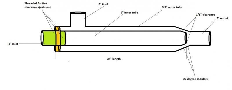

Here's what I have been able to design using the limited info available online.
Please feel free to give feedback about what I got wrong. I'd like to get it as close to right the first time as possible. The only part of the jet I don't have the ability to make myself is the tapered cone on the outlet end, but my local machine shop can. I'll then weld it all together myself.
I know a high pressure pump will create more suction but with the supposed 3x increase in suction over a standard type suction nozzle, I wonder if a much cheaper lower pressure trash pump might work at least as well as a standard nozzle until I acquire a better pump.

here some info on the couple-jet it has some sepc's for water needs
Wow! Some good info, Thanks

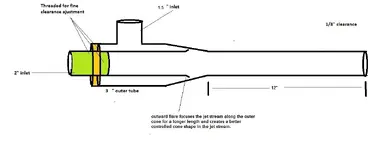

I modified your pic with my recommendations. I built many infinity jets like this and it is easy and works great. The pressure chamber doesn't need to be more than 4-5 inches long. 15degree cone 3"-2" reducer (can find exhaust header reducers already made online, but look for a good cone shape)

Thanks for the info.
I thought the flair needed to be tapered inward the same angle as the cone for smooth flow.
Should the jet be located on the crashbox like a jet log or on the hose end like a standard style?
This is what I'm considering using for the flair.
The outward flare creates the jet aperture far enough back along the wall of the cone to utilize more of the cone for jet stream control. I use 16g stainless for this design or you can use 16g regular steel and allows the aperture to be made easily. Thick walled steel like your picture could be ground beveled on the inner pipe to create the aperture or just cut flush since it will naturally sit further back up the cone, but since thin walled steel doesn't have enough dimensional thickness to utilize the length of cone required, I employ this technique and it makes for a much lighter jet than thick steel. You will also want to install set screws to hold the inner pipe centered.
Jet placement is best determined by how you are using the dredge. If you are working a lot of shallow areas where air is often sucked into the system, then placing the jet further forward in the line helps reduce loss of prime. Otherwise the best suction will come from having the jet back near the crashbox. Placing the jet 4-5ft forward of the crashbox can give good suction and reduce the problems of losing prime in shallow water.

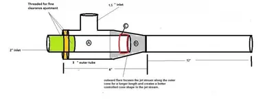

I also miss-named what the above pieces would be for, I meant to use one of the above for part "B ", the outer cone, since the taper seems nice and gradual for less flow resistance. I'd like to use stainless exhaust pipe for part "A", and what about adding a second layer, part "C", to the end of "A", and grinding a taper for more flow contact with the cone?

May I make a suggestion on the end that you have for fine adjustment dont thread if your going to michine the plat michine it from bar sock and have a collar going out the back and cut inside for (2) o-rings and have a ss all thred with 2 nuts for adjustment.
just my 2 cents
The point of the flare is to create a focused aperture that points directly back and let the 15deg cone shape the jet stream angle for best operation. It simply reduces the need for welding additional thickness/shaping the inner pipe with a grinder. Without some form of angle control, the main jet stream will travel the walls of the exhaust pipe and will still work, but will not be as strong as a jet stream that is focused to the middle of the jet. I simply present a simpler way to provide this directivity. A jet aperture does not need to be a long length of restriction to work well. As far as the bell reducer, there are plenty of 16ga stainless reducers available for automotive and sanitary applications which will be easier to weld together than the thick weld reducers and are significantly less expensive.
Good idea Bill. He will want adjustability for both setting the gap and cleaning debris out of the orifice.
plus the addition of a vacumn gauge at the devices inlet tube will give him a "best" adjustment setting for the pump he is using! this way he can tell at what adjustment will give him the strongest / best suction !
