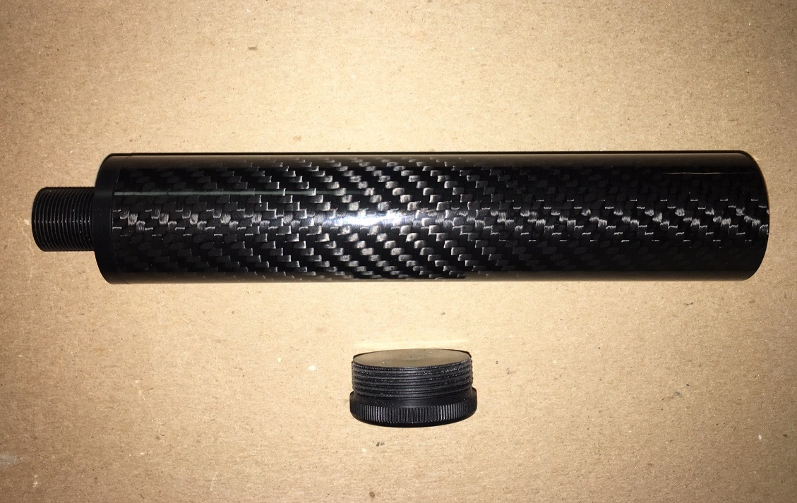

Thanks, all, for your suggestions throughout the thread.
I just thought I'd provide an update, on the final counterweight design. Parts arrived today, for the tubes. I'm VERY pleased with how they have turned out! Here is a 6 15/16" counterweight tube for the Minelab Equinox carbon-fiber shaft, which is capable of holding up to 30 oz. weight. Remember, any weight/length of tube can be produced, up to the full 6 15/16", per customer needs/desires.
Thanks!
Steve
