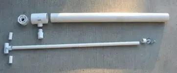

its hard to get the gold behind boulders in moving water, gold is heavy and keeps falling to the bottom of the hole.
I would suggest getting hand sucker tube,(hand dredge) or build your own or modify a shrimp gun.
also works good dumping a bucket of water in a hole or crack to get all the goodies out.
here's the one I have; Gold Prospecting Equipment by Gold-N-Sand
or build one but with a small tip/extension
Agreed! I found my first picker on the first day that I used my modified shrimp gun. :thumbsup: Only thing with mine is it really needs a one way check valve. It will save you a lot of aggravation. :BangHead:
