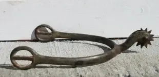

Is this a CSA Spur
outtair

Recently met a man who had a Great Grandfather who was in the 15th Confederate Cavalry, Company C. He said when his grandfather died they found these spurs in the house. These look like M1885 spurs: they are 1/2 round strap and curved shank. The interesting thing is no manufacutures name but a stamp on the shank that I tried to picture. It is an anchor. Any help on this?
Thanks,
Tim

Don't know of it's CSA or not but here are more spurs with the anchor mark:
North & Judd spurs on ebay. No date given.
Hope this helps.
DCMatt
Thanks, that is the exact mark on the spur. I will check the site.
Tim
definitely not a Union spur. My Crouch relic book has plenty of Confederate spurs, but none close. Most spurs in my civil war relic book by Crouch have squared ends where the leather attaches.
That is not to say that they are not Confederate. There is one set in the Crouch book that has round ends and it lists them as: "a small, lightly constructed spure that could have been used by a woman". I am sure there were many other types of spurs used during the civil war. Many Confederate soldiers did not even have uniforms so those soldiers may have used very different spurs.
No matter, great set of spurs.
Let us know if you find anything out.
Great ID guys...
I agree with jhettel - while they may have been worn during the war by someone... they are not military issue, which makes it really hard to attribute them to anything, but that they were owned by an old soldier... which in itself is pretty cool.
Great spurs and great ID Matt.
Thanks for all the help. The most interesting thing is to find out about the maker mark anchor and that it is a North and Judd. I read about them and found out that they had a US Army contracts through WWI and they were one of the Big 3 in spur manufacturing. I picked up some Crockett spurs while living out West but did not know about North & Judd. My best guess is this veteran bought these after the war and used them while still riding in a cattle operation he had.
