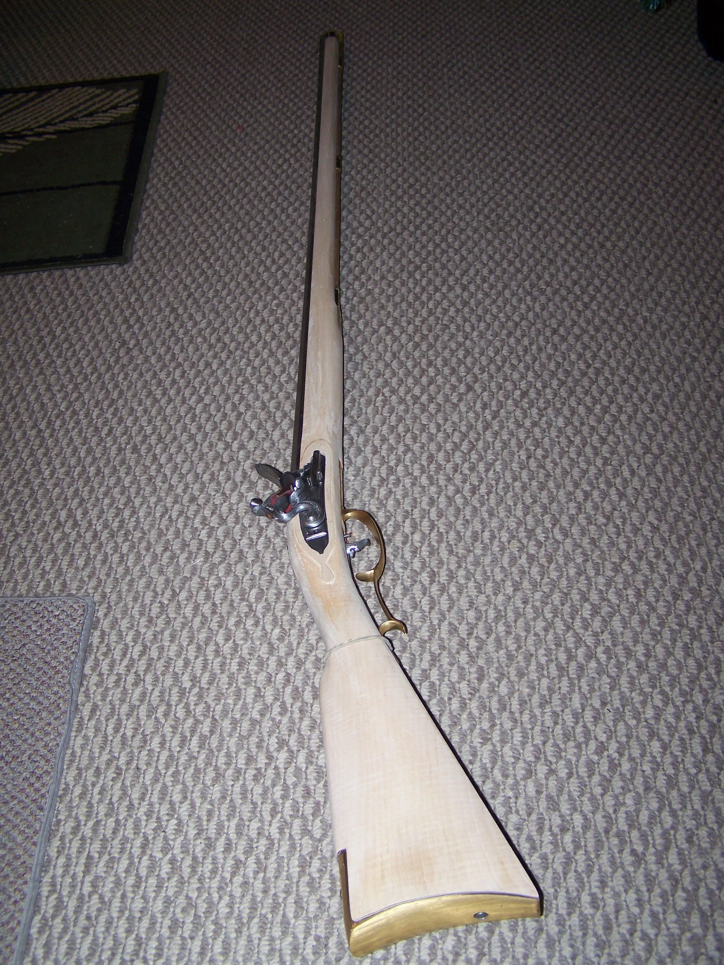

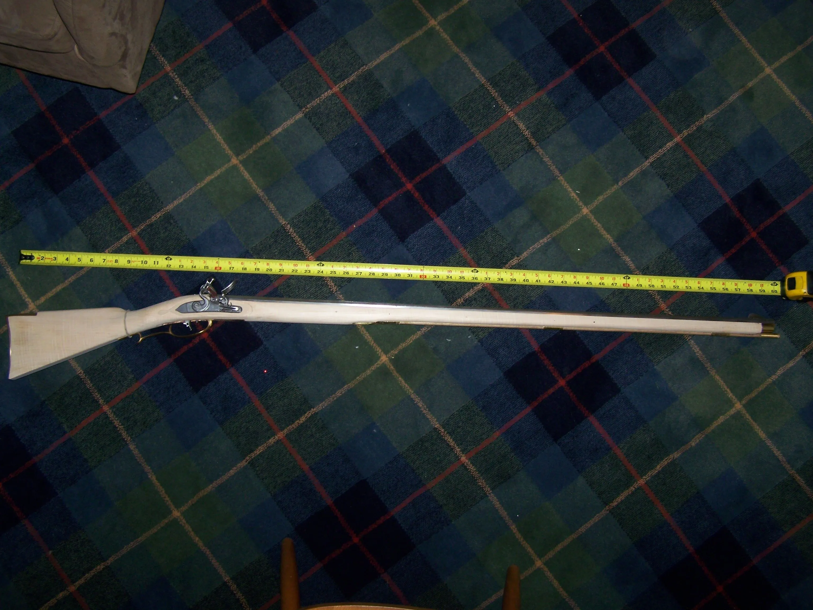

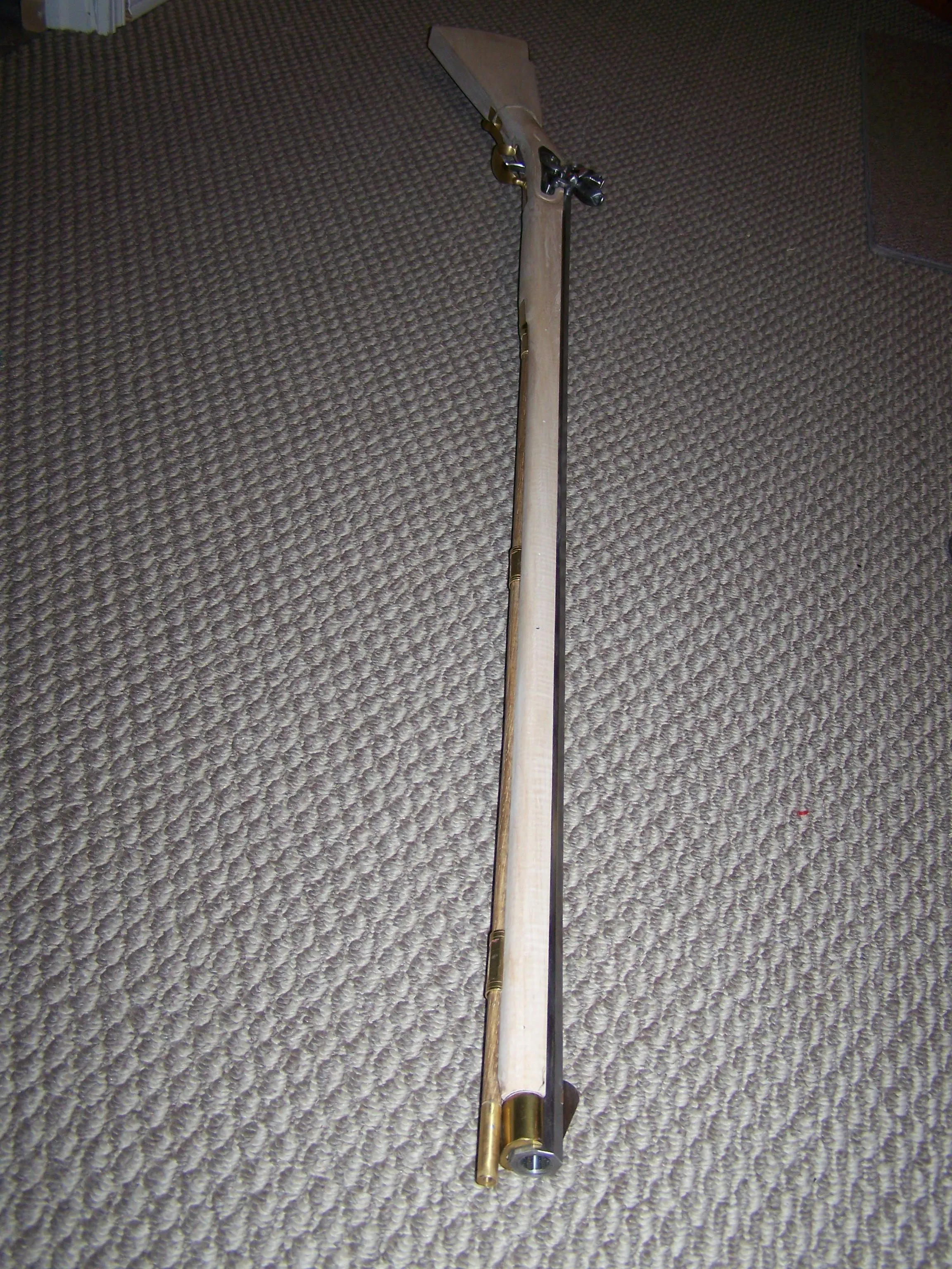

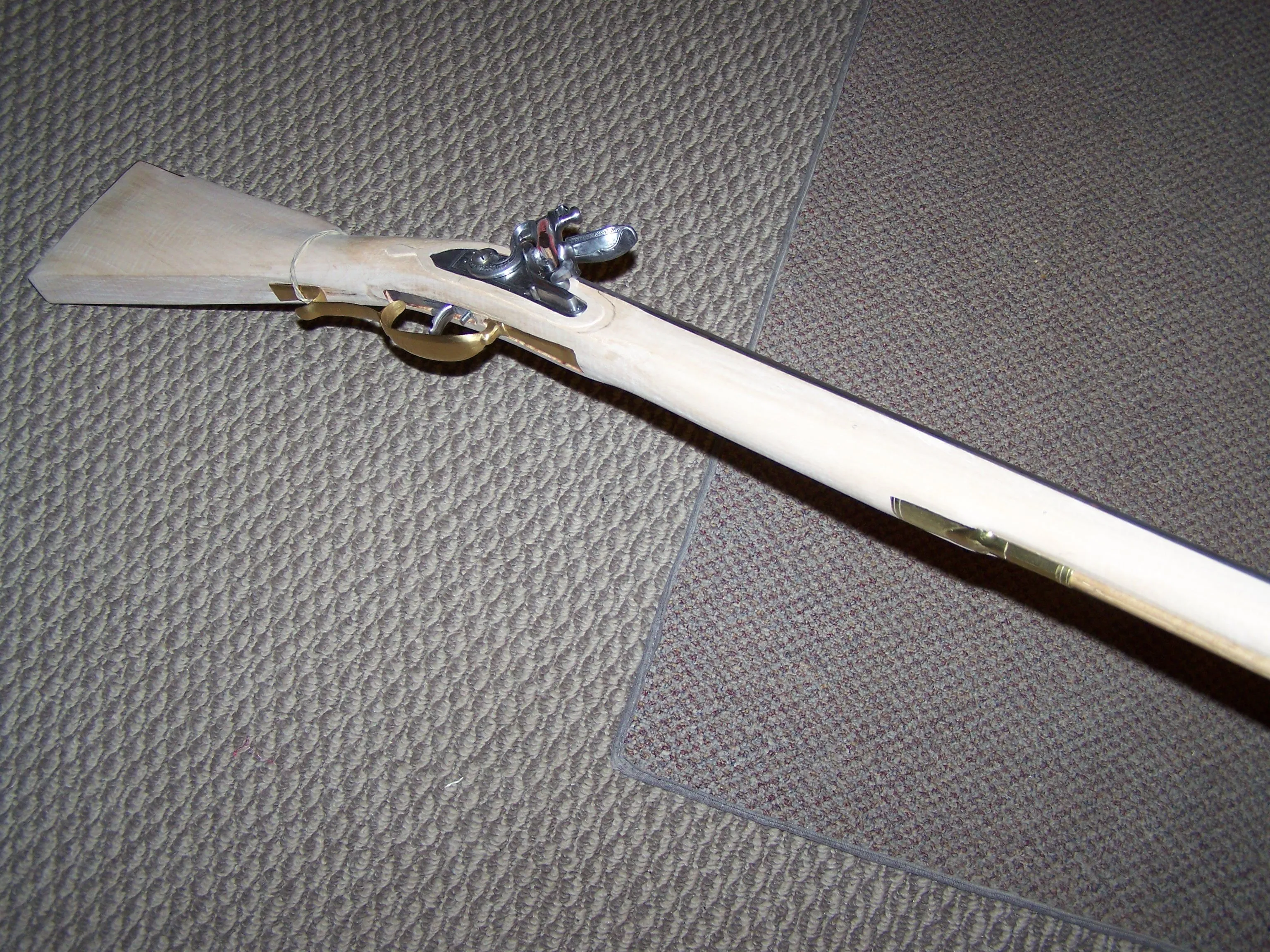

My progress to the end of 2018. Still a lot of wood to come off to get it slim like the originals from the Golden Age of long rifles circa. 1780-1820 or so.........................Daniel 146_3899.webp146_3900.webp146_3901.webp146_3902.webp
Was this rifle made with a kit?
I wonder of an old musket ball of the same caliber could be shot out of this firearm.
No rush. No rush. L.o.l...
Looking real nice. Any particular school being followed? (A Pennsylvania region or something?)
What is the ring on the stocks wrist?
And unsolicited advice here , don't drop the stock at this stage. (!)
Yes, a retired gent from Ontario sold these kits. When finished I will load a .530 diameter ball with a patch .018 thick and approx. 70 gr. of ffg black powder.
No particular school although Lancaster inspired. Lock is a copy of a Durs Egg. The "ring" on the stock is an elastic band holding the trigger guard in place as the guard will not be fully inlet until the wrist is slimmed down. I'll try not to drop it. LOL Thanks for the comment.......................Daniel

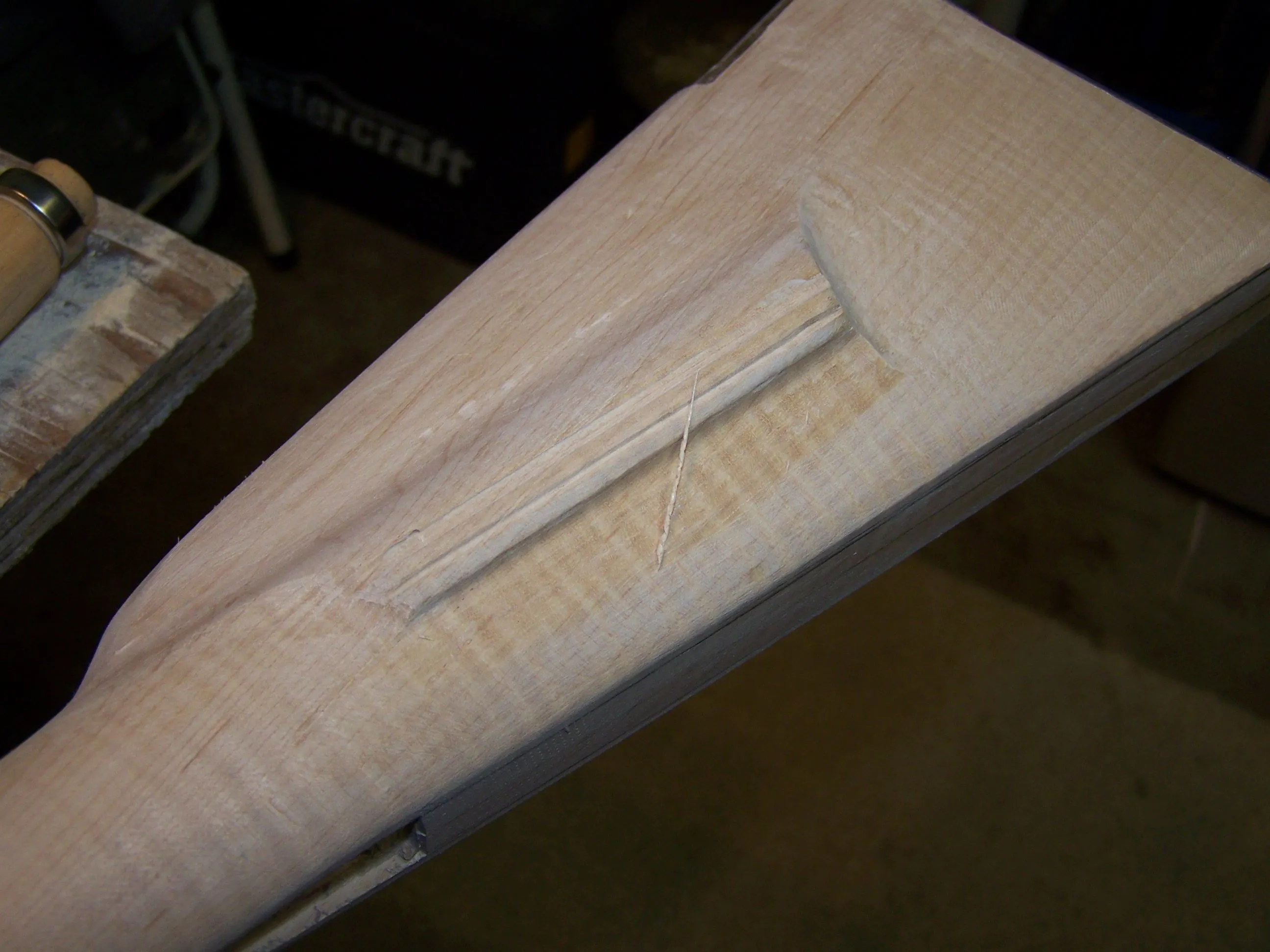

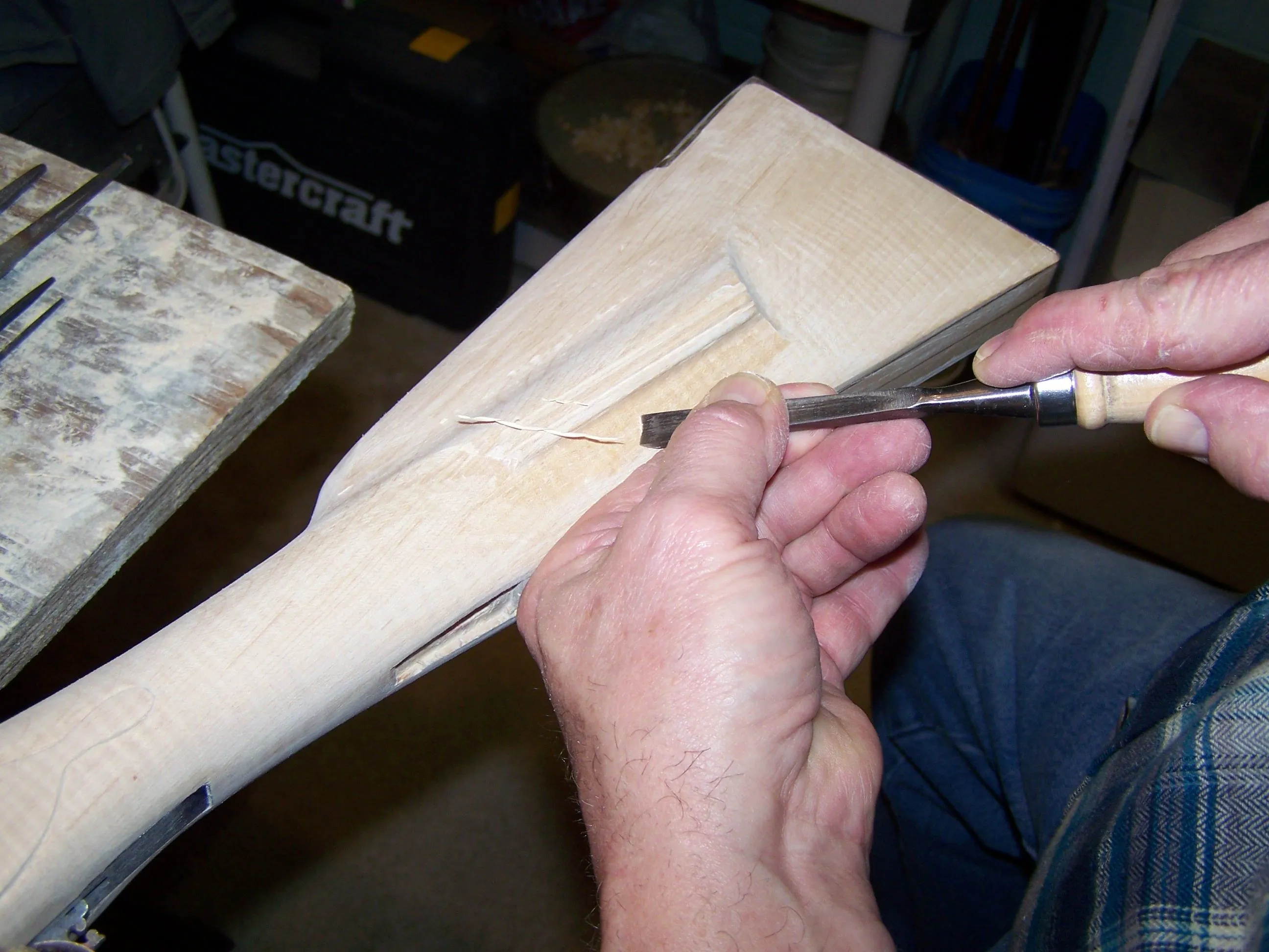

Started sculpting my cheekpiece and the Wife was kind enough to snap an"action shot"..........................Daniel146_3921.webp146_3919.webp
Daniel,
It looks loke the cheek piece is coming along just fine.

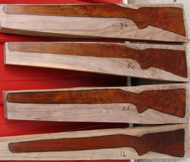

I have a question. I have a sawmill and cut walnut for gunstocks. So far, all modern guns. How long is your stock? From you tape measure is looks like 5'...?? I'd like to cut some stock blanks for BP rifles to have on hand. Thanks. Gary
Curly maple? Looks like the wood is going to be gorgeous once it has a finish on it. Nice work.
Those blanks look nice. Good job.........................Daniel

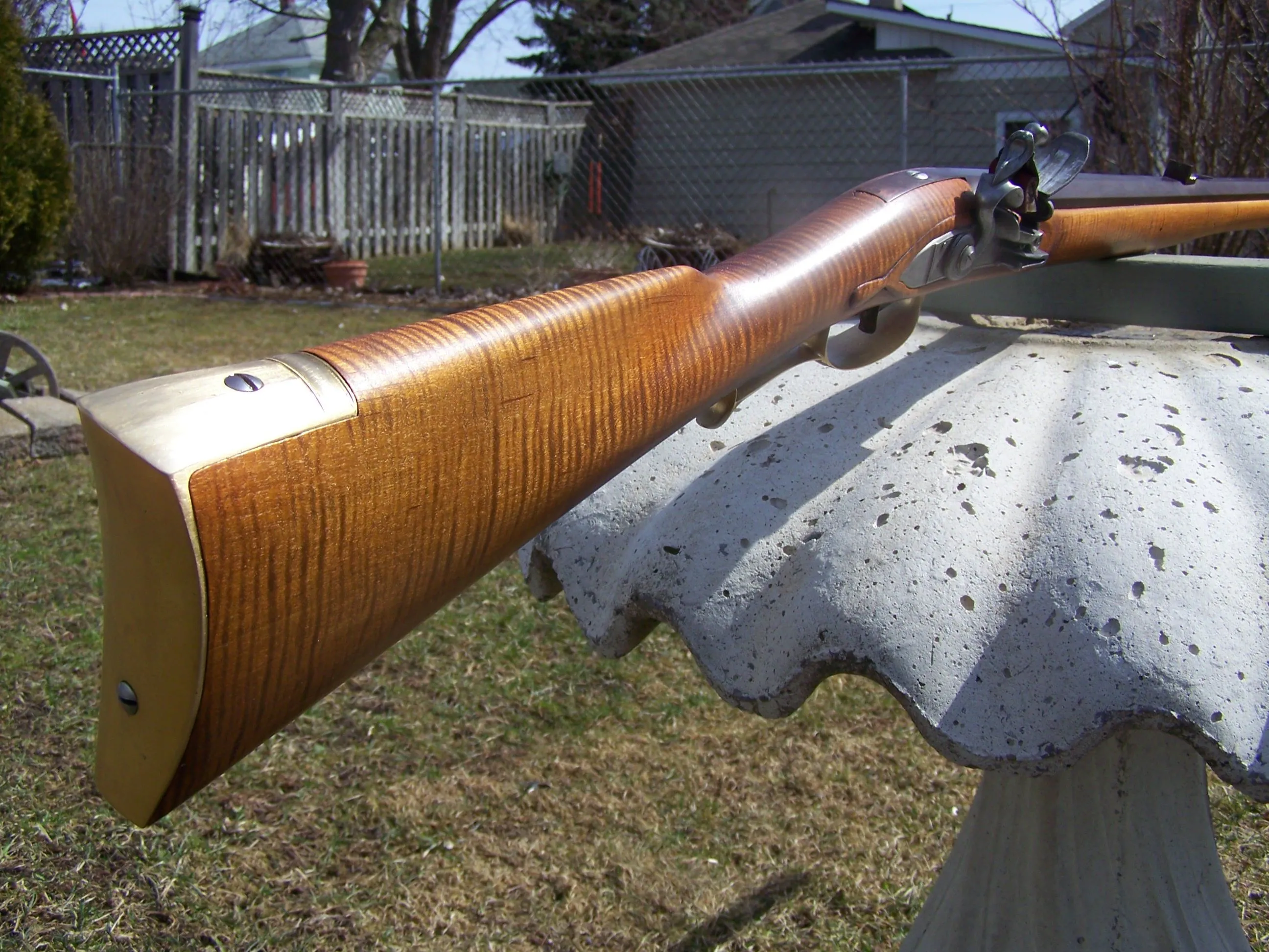

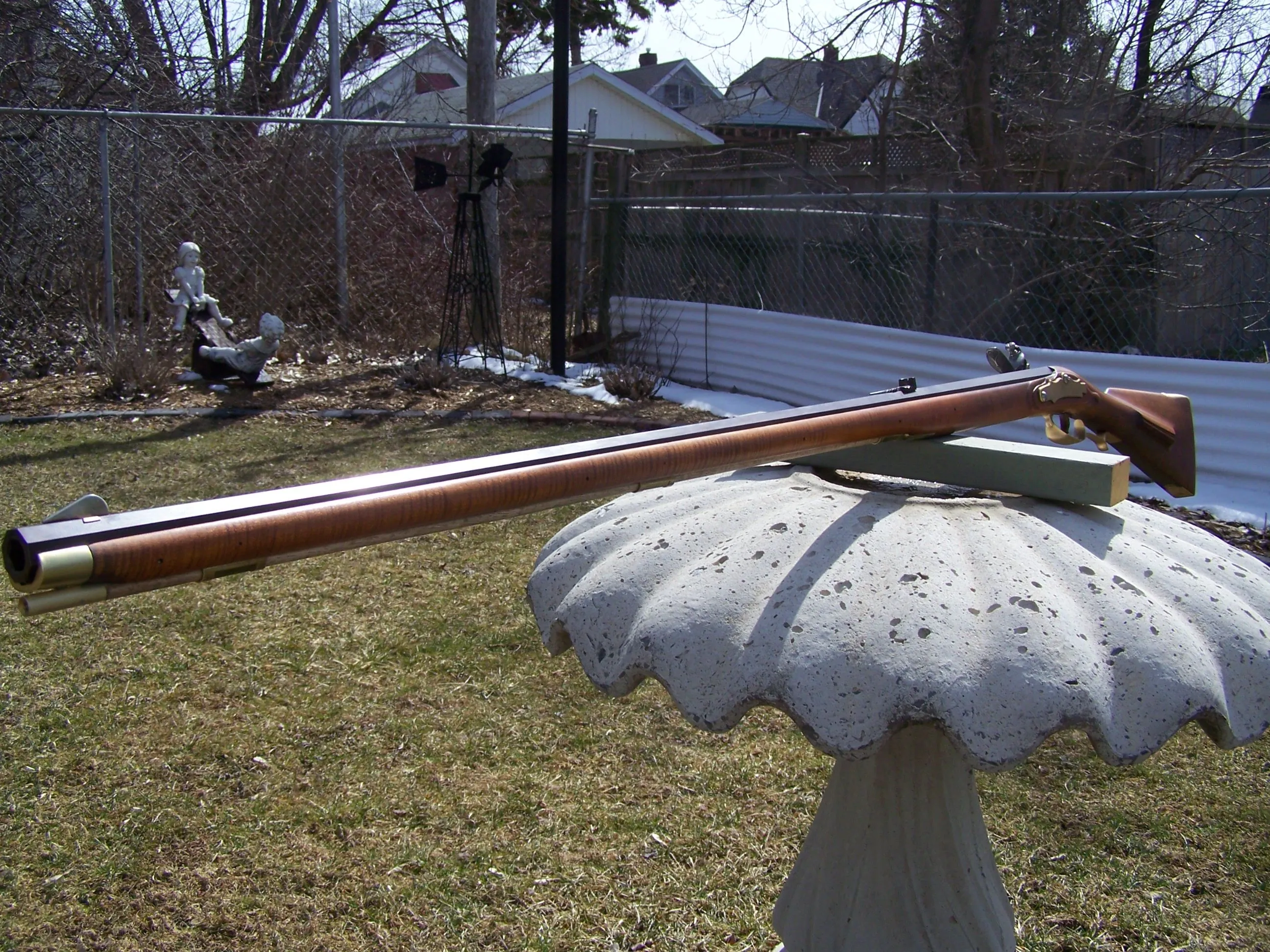

Finally finished and I took it to the range. A pleasure to shoot but have to file down the front sight cuz it shoots quite low...............Daniel146_3970.webp146_3972.webp
Very nice. You picked a nice piece of lumber.
Beautiful job on the Long Rifle. I know you have to be proud and rightfully so. That was a lot of work, but it paid off.
Beautiful piece. I love the curl on that wood. Gary
Really nice rifle.
I've always wanted a Hawken plains rifle . 50 cal.
