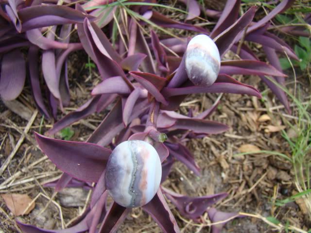

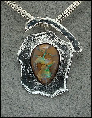

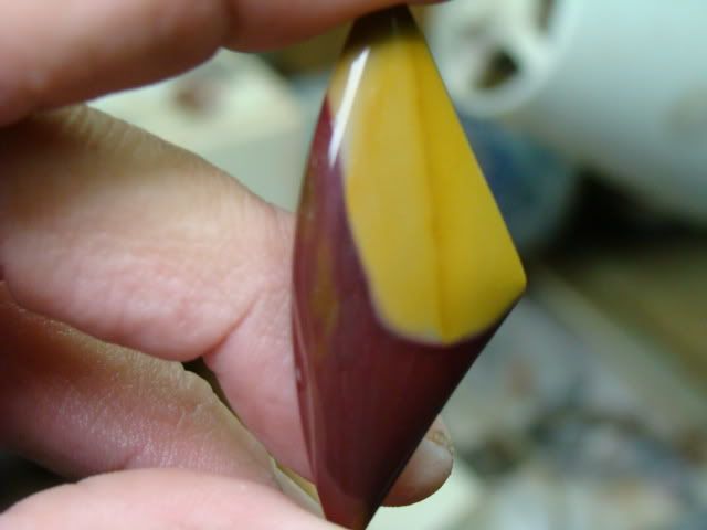

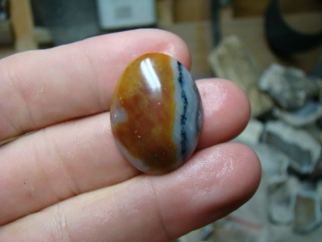

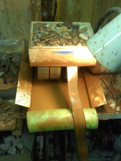

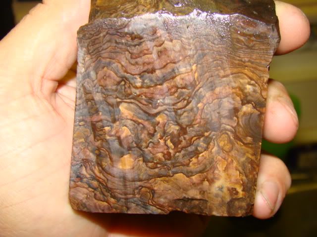

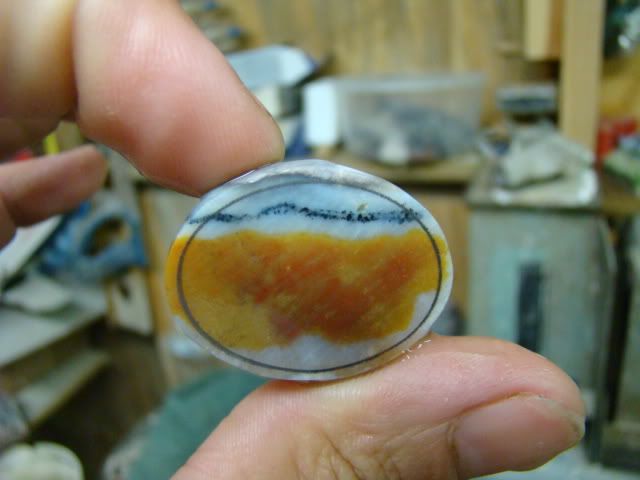

here are some cabs I have made. I havent workedanythingin at least a year. I wore down a wheel on the cabbing machine and have never replaced it and then work and life got in the way. The Boulder Opal I traded for from my friend Gene, he goes by Oubla on ebay and he lives near me and has his own mine in Australia. I love working that hematite messy stuff, it will ruin any shop with its mud like colors,lol
I dig and hoard coral down here and have traded it over the years for other materials, so here are some pics of different materils I have and have cabbed
