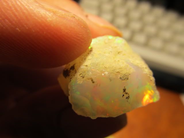

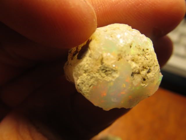

this is a small batch of opal I bought from a jeweler friend, I figured if I liked boulder opal I wouldlove this stuff. I bought the mid grade he had and the first 4 pieces I worked trying to cab all cracked. I guess either the heat from too much wheel contact got them or they rehydrated and broke. I had 1 last piece and I worked it very slowly for a few hours, very little water etc. After I cleaned the cortex and could really see into it I knew I wasnt cabbing this one anymore.

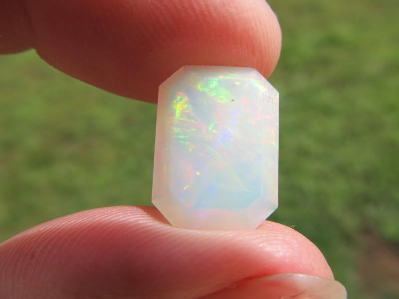

I took it back to him and had him facet it for me and it turned I out I got the better deal on him. lol He didnt think this big chunk was any good , he thought a sand pit rand through it, it didt.
I ended up with a 6.5 carat opal . I/we turned a #150 pile of rocks into a $5000 ring
