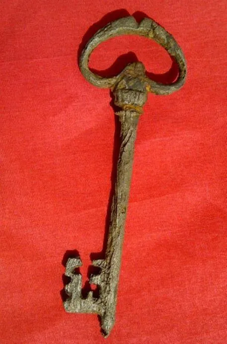

Approximately 30 days in apple cider vinegar interspersed with some coaxing with a wire brush.

Your big key came out nice. I am trying the apple cider vinegar on a smaller key. A LOT of rust came off after a week. I'll leave it in another week. I might try Cityboy's method on some other iron.

love the old key!
That key is awesome! Turned out really nice. Congrats!
Whatever you did was perfect,it has just the right amount of rust taken off to get the details visable. Never heard of the molasses treatment Citiboy but it sure is good on biscuits.

Great job on that key! I use the same method & just finished an iron key, although not as nice as yours.
Great job on the restoration romeo, the key looks amazing! :occasion14:
