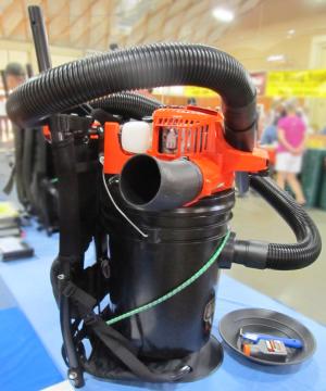

Most if not all the drywasher in this class are using a leaf blower. I build what I call a Viper-Vac. The link is in my signature below. I use strictly the Echo PB-255 due to its low fuel consumption and is about the quietest blower on the market for a two stroke engine at nearly 400 CFM. The vac's can be used as a blower for your drywasher and then used as a bucket vacuum. You have the best of both worlds, but your going to spend $200.00 for the blower. Either way you should look at a Stihl or a Echo. Stihl has a great reputation for its long life. I use the Echo for its mounted system onto a bucket that no other blower can match. Like any other two stroke motor the key to longevity is running the fuel system dry after every use and not using old fuel mixture that been sitting for a long time. Only mix what you will use.

problem with most leaf blowers is you have to turn them on there side to mount on the lid, and after a couple of season you will begin to smell the gas leaking out.
there is a leaf blower out on the market that sucks air from the bottom rather then from the side of the unit about 70, 80 green backs, don't remember who makes it.

LOL, this is about the most ridiculous reason not to mount the Echo PB-255 on its side. Once the PB-255 is mounted on its side places the fuel fuel tank and cap in a position NOT to leak. Furthermore the fuel pickup tube is weighted placing the the fuel pickup at the bottom of the tank. It also places the pump bulb, the choke, and the pull start on top in a accessible position for the user.
When I went on this mission to build the best Vac / Blower on the market I looked at every leaf blower on the market. The Echo PB -255 and PB-251 fit the bill.
