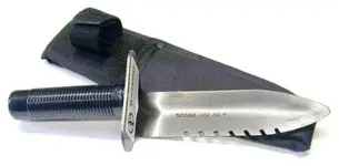

So I know they make a Lesche Digger in both LH and RH configurations with the difference being the serrated side of the blade being on one side or the other.
They state the RH has the serrated side on the right of the blade if you are digging ......
Amazon.com: Standard Lesche Digging Tool & Sod Cutter (Right Serrated Blade): Sports & Outdoors
And the LH has the serrated side on the left side of the blade when digging......
Lesche Digging Tool & Sod Cutter & Free Sheath! (Serrated on Left Side) - Home And Garden Products - Amazon.com
Question is ...........
Are you Right or Left handed and which side of the blade do you prefer to be serrated?
I read more about the RH and more have bought that model based on say Amazon reviews ... but I got some info from Wayne at Metaldetectorstuff.com stating "most right handed people prefer to have serrations on the left side so that they are digging clockwise (towards them). Serrations on the right side require a counter clockwise motion to dig using the serrations (away from you). Now if you are left handed, most prefer the RH model. "
So I want to make sure I get the one that will be for a right handed digger as I for some reason have seen the opposite most of the time in pics etc. and would think the even being right handed the serrated on the right would be better no? Mind you I haven;t dug a detecting whole with a hand digger in over 15 years so I am not sure exactly how my motion would be.
Thanks for any info you can provide on these two options with the Lesche Diggers! :icon_thumleft:

I'm right handed and I use the left handed Lesche. I cut plugs in both directions. Mostly one handed digs unless the dirt is crazy packed then i use the 'lip' on Lesche to really force it down.

You don't actually plunge the Lesche into the ground and scoop; unless perhaps it is a really shallow target. Even on shallow targets (1" or less) the most I will do is cut approximately a 2" slit in the ground and then either pop the coin up with the tip of the Lesche or use a screwdriver to do so. Mostly, I use the Lesche to "saw cut" a hole in the ground approximately 3" in diameter and then pry up a plug, which is usually 4-6 inches deep. I only scoop with the Lesche in order to dig some of the dirt out of the hole in order to find the coin. This is where the pinpointer plays a part in help determining where to remove/scoop the dirt. Also, I am always careful to overshoot where I think the coin is. For example, if I think that I can remove the coin in a tablespoon of dirt, I will remove twice or four times that amount in order to negate scratching the coin.
I use the Jackson 7 in one digging tool and it is serrated on the right side of the blade and a sharpened left edge. I use my right hand to cut the plug starting at the 12 o'clock position and moving counter clock wise till the plug is fully cut. The serrated edge makes a big difference on the Jackson multi digger and is much faster as it cuts the grass or tree roots to release the plug.

You can simulate the plug cutting action with a hunting knife or serrated steak knife in your own yard. Take the knife and cut a square 6" on three sides. Face the blade in your right hand facing right and cut a plug in clockwise, then do one counter clockwise. Now turn the blade to the left, and repeat clockwise and counter clockwise. The sawing action helps to cut the grass roots and small tree roots. When you decide which one is easiest, pick the serrated edge that meets your needs.
Rumor has it that the original designer, George Lesche SR, was left handed. After several years of making the diggers, a request was made to make them with left serrations, and those are called LH. We carry both models, but left serration outsell the right serration by a margin of 9 to 1.

I am right handed and when I dig I feel it is more natural for me to cut my plug in a counter clockwise direction.
So which do you use?
I use it with the serrations on the right hand side.
Im right handed and have the right hand model of lesche,but wish I had the left sided serrations. I usually start the plugs at 3 oclock and work clock wise towards me, leaving the 12 oclock position uncut if possible and push the plug up to 12. And I sharpen the left side of the tool!
I'm right handed and have the right hand model of lesche,but wish I had the left sided serrations. I usually start the plugs at 3 o'clock and work clock wise towards me, leaving the 12 o'clock position uncut if possible and push the plug up to 12. And I sharpen the left side of the tool!
Ya i figured this out myself as well .... seems like if I cut a plug I would do just about what you do as being right handed you want to work kinda towards you body to have more leverage and better power with your cuts so working clockwise makes sense .... in turn I could see how the newer left sided serrations (this is you are holding as if you are about ready to make a cut the serrations on are the left side of the blade not right) would be way batter cause that is the side you are pulling into the ground with.
Thanks for all the info guys ... when I go to buy my Lesche I will be getting the LH ... which I guess is there term for edges on the left of the blade as I think if you are right handed you want that and if you are left handed you want the standard right sides serrations.
