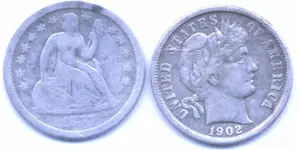

Haven't used the SL mode enough either, so I am confident when I start using that regularly, I'll be getting better depth. So far though I have a fine time swinging that thing. Here's one for you I got a couple weeks ago, amid a lot of .22 short shells at 5 inches+ angled into some roots, a '57 seated and it was clear as a bell reading a solid 78 if I remember.
Thing is once I heard that high note I slowed down that coil until I was just hitting this target and the machine pinpointed it under the coil at the spot fo the signal. The '02 was easier, flat and 5" down, no trash around and the same, solid read.
Gotta get the coil over it too read it, and gotta swing slow to find it, especially if there's trash around. For these two, I had sense 95, thresh 0, 3H tones and they were in ground that FG'ed around 75-80.
