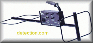

I have one of these....it should do what you need. :thumbsup:
http://www.detection.com/Discovery/Tf900.html
Timberwolf
Wolf, I use the Garrett 2500 with the two box. :thumbsup:
