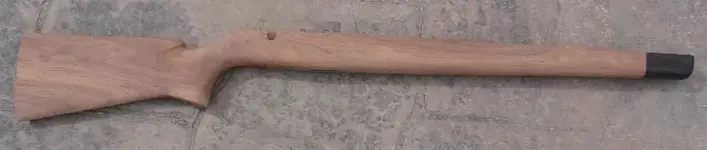

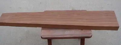

All you should have to do is remove the stock and take it along with your blank to a guy that has a gunstock duplicator machine. Even though the butt is broken, the duplicator operator can fudge and make it. I have a good duplicator guy here in IL. PM me and I'll give you his contact info. He may be able to help you. Cool project. Inletting the long stock by hand would be a nightmare. Here's a blank he did for me. Remington 513T .22 converted to Mannlicher style stock. Gary

I've done this for 40 yrs. and I must say inletting your project from scratch without running it on a duplicator would be incredibly hard for your first inletting job. Sidelocks are very difficult. Good luck to you. Gary
