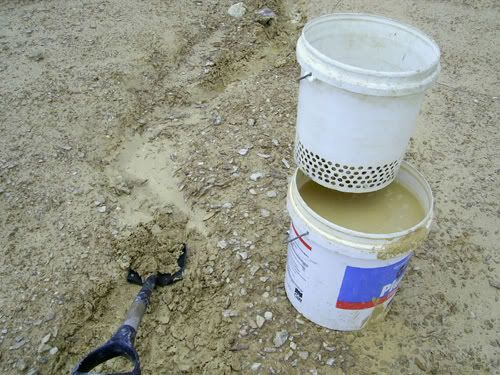

Kiwi I like your bucket classifier, but the reason I made this one for two buckets was because a single bucket classifier just felt too slow to me. The main holdup for filling a single bucket seemed to me the classifying, and with a bigger classifier I can fill two buckets in the same amount of time I could classify a single bucket, just using a bucket classifier. This way is faster because I can pretty much shovel nonstop, and I dont have to stop and take out the big rocks after every shovelful. After about 5-6 shovelfuls I do have to remove the big rocks but other then that its smooth sailing.
